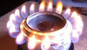

Introduction: How to Make an Alcohol Stove
An stove made from a tin for survival or camping purposes
Step 1: Get a Suitable Tin
Get a tin that you can use for your stove. Make sure that you choose one that can hold a pot comfortably.
Step 2: Create Circle for Hole Placement
Draw a circle the size of the tin lid. Divide that cicle into 16 pieces.
Step 3: Make Holes in the Cicle
Use a toothpick to make holes on the edge of every line and inbetween the two lines
Step 4: Attach the Circle to the Lid
Roll up a piece of tape with the sticky side on the outside. Place the tape in the middle of the circle. Place the circle on the lid.
Step 5: Marking the Holes
Take a permanent marker and mark the holes onto the lid.
Step 6: Making the Holes
Take a hammer and nail and hammer a hole where all the permanent maker dots are.
Step 7: Pouring the Alcohol
Pour alcohol into the tin
Step 8: Lighting the Stove
Hold a lighter below the stove. Wait for a few moments then place a lighter on the top of the stove. The stove will then ignite.
