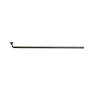

  1. bike shift inner cable (at least 15cm but one full cable cost between 2 and 4euros so it should be OK...)
  2. Bike's spoke (at least 1)

Step 2: 2. Sharp the Bike Spoke
If you want to be able to catch the rope in the hole, you neek to have a good hook. So you have to sharp it as good as you can.
So basically, you have to take the metal lime, the spoke and and some elbow grease !

Take the bike inner cable and cut a piece (between 10 and 15cm length looks good). Put it in the luster terminal and thighten the screw
Put the bike spoke in the other part of the luster terminal and thigthen the screw.
