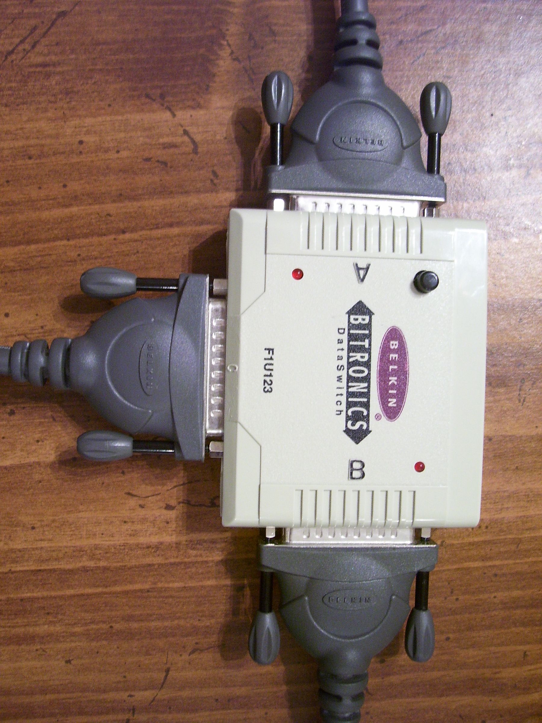

Step 2: Removal of the Power Plug
now's where you'll need a Dremmel Tool.
and skill.
take the PC Board and your Dremmel equipped with a cutting disc and cut the plug between the power jack and what ever's next to it as cleenly as possible so that they're seperated.
Time for De-Soldering!
Carefuly, without melting the plug, remove it from the board by removing solder, or just find your own method.
whatever works best.
and skill.
