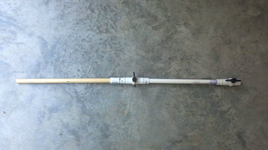

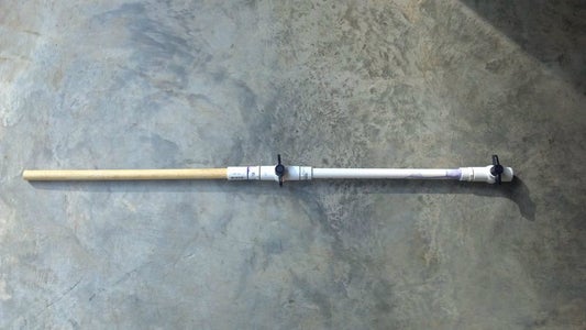

This is a very easy project to build. All you need to do is attach two ball valves to a section of pipe and add a coupling to the end of one of the valves. You also need another section of pipe to serve as the barrel; it should be a similar size to the other part we just made. You can use any size of PVC parts that you have because it doesn't need to withstand that much pressure. In the pictures above, I used 1/2" parts and the chamber is 16 inches. The chamber should be very long or wide because when the baking soda and vinegar are mixed, it will expand and produce CO2 and water, so there needs to be enough room for the CO2 to form and for the mix to expand. Remember that the larger you chamber is, the more baking soda and vinegar you will need/have the potential to use.

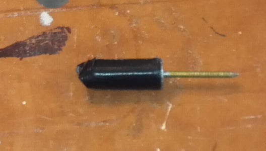

After that, you will need to make a projectile. Remember the chemical reaction we just went over? When we combine the baking soda and vinegar, it produces CO2 and a lot of liquid. It is important to keep this in mind because the projectile has to be able to hold up against all of the high pressure liquid. This means that the ideal projectile to use is a dart with solid feathering. I make feathering by wrapping duct tape around a nail. Sponge also works, but it is challenging to work with when it is dry. Any dart will work as long as the feathering isn't made out of paper or a flimsy material.
Here's the basics of how this gun works: the ball valve at the back is opened to pour in the baking soda and vinegar. When it is closed, the combination of baking soda and vinegar rapidly produces pressurized CO2 in the chamber of the gun. When the ball valve in the front near the coupling is opened, this CO2 goes into the barrel and propels the projectile. In the next steps we will go over the specific details of the chemical reaction and how to use the gun.
