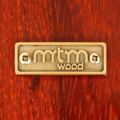

Also I engraved my logo at the CNC machine.
