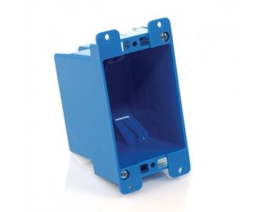

3. A 14 Cubic Inch Zip Box - 2$

Take the two ends of the extension cord and thread them into the zip box (the blue thing).

Screw the WeMo into the zip box making sure that none of the colored wires are accessible to people.
