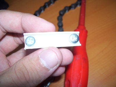

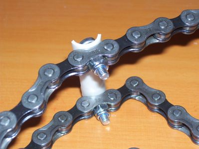

Step 2: Get Buildin'!
Cut tube in segments slightly bigger than the wheel you will mount the on, and cut those segments in half with knife or scissors.
Step 3: Drill
Drill both ends of the tube halves with the 3mm drill bit, Insert screw in chain's thickest type of link, and tighten self tightening bolt.
Do the same for the other screw.
Step 4: Keep Tightening... and Oh, You're Done!
Tightening all the tube halves takes time, but after finished it's worth it :-)
