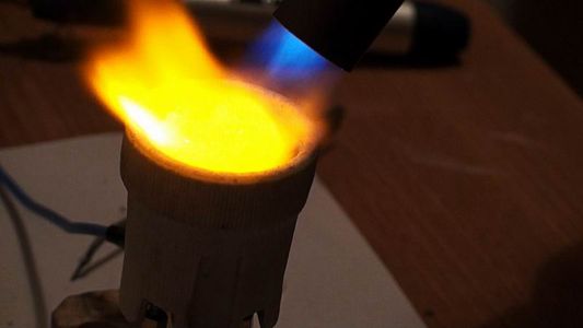

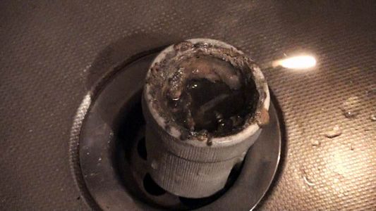

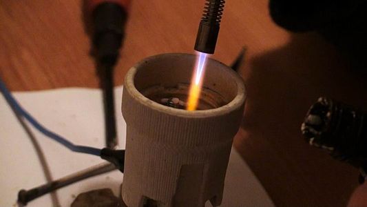

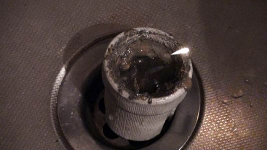

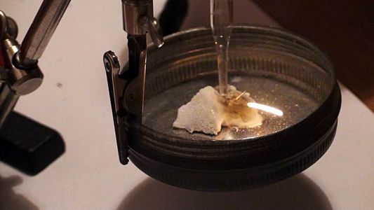

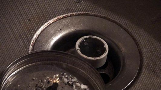

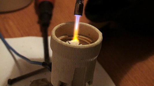

Step 1:
Step 1: prepare a ceramic container. There are various choices here, from ceramic light bulb sockets, to light spot ceramic connectors.
Step 2:
Step 2: insert two steel screws are electrodes.
Step 3:
Step 3: add some sodium hydroxide, melt it superficially using a butane torch, and connect the electrodes to a high current voltage supply
