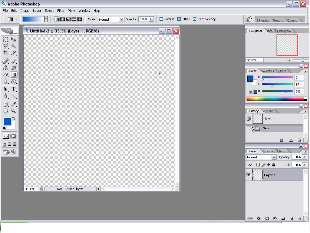

Step 1: Open Up the File
now we open up a new file with no background.

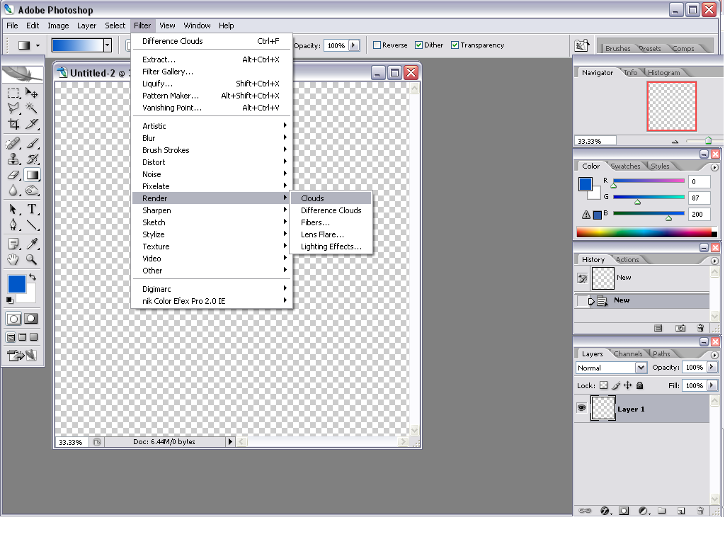

Step 2: Cloud Time
now we go to filter>render>clouds. make sure you color is blue then white.

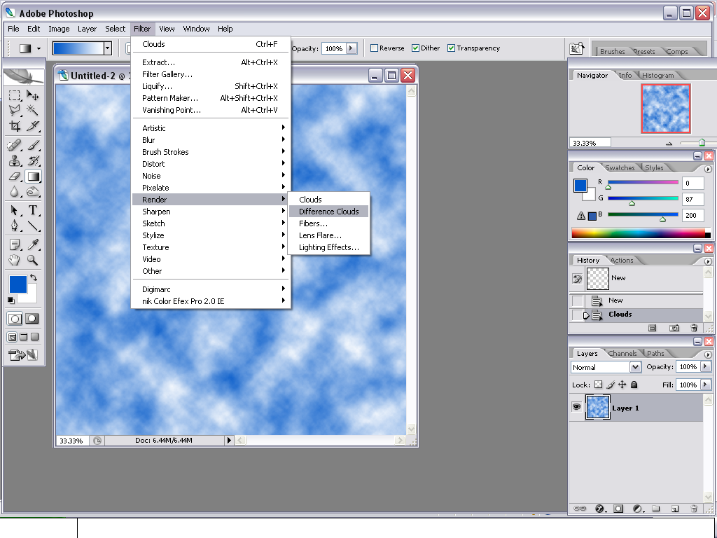

Step 3: Change the Clouds!
now go to filter>render>difference clouds.

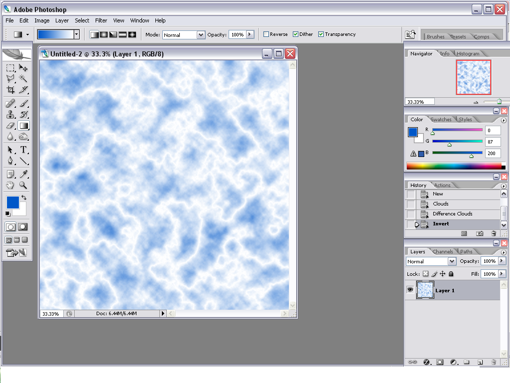

Step 4: Invert
now click crtl+I. or invert for some people.

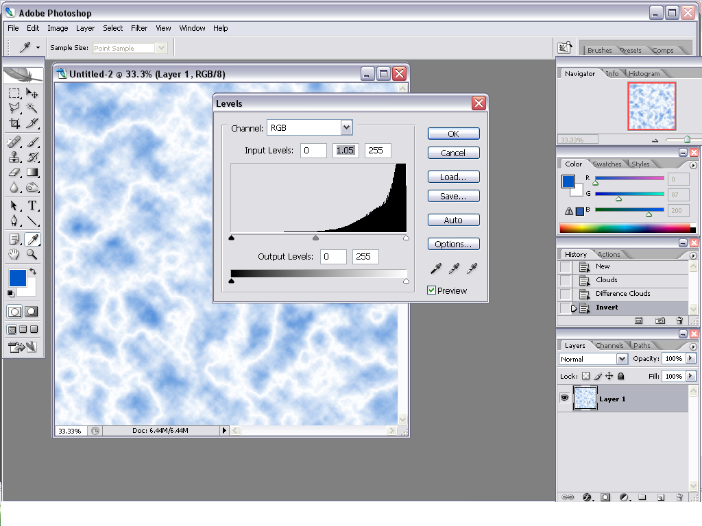

Step 5: Levels
go to image>adjustments>levels. then slide the bar all the way to the right.
