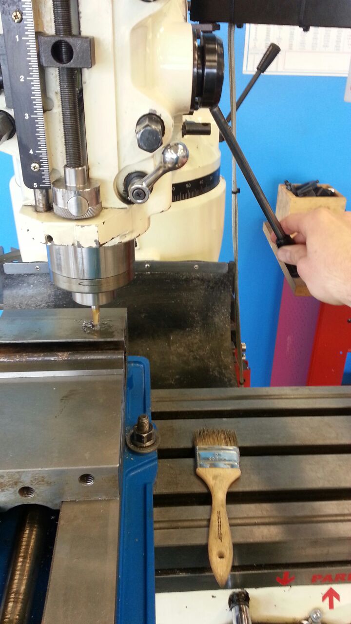

Step 2: Setting Up Your Piece & Machine
Securing your work is really the trick to this entire thing. The milling is easy. I found this to be the easiest way to clamp your angle iron and get it ready for milling.
Please see my notes inside the image for details.
Put your endmill in the machine and set your speed. I'm using a 5/16" endmill, so I used the following calculation:
172 / 0.3125 = 535 RPM
Once your material is secure and the endmill is installed, you can optionally position the endmill where you need it and set your zeros.
Step 3: Mill the Hole
Now it's time to turn on the machine and start milling.
Apply some coolant or cutting oil to your material. Begin by plunging into the material. When you do this, peck at it by only going a short ways in, then backing off. For my material and endmill size (1/8" steel and 5/16" cutter), I decided to make my slot in 3 passes. So I only went 1/3rd the way through the material.
When you get to your desired depth, use the quill lock to hold it in place. Now, move your X or Y axis (depending on which way you're making your slot) very slowly. Continue to apply coolant and use your paint brush to remove chips and see what you're doing.
Repeat until you are all the way through the material.
