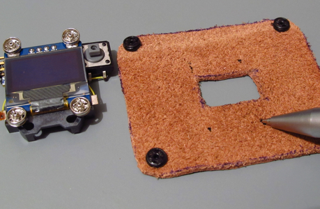

Step 2: Preparing Leather - 1
In this step we are going to prepare natural leather.

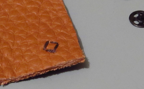

Place your display on the leather. This will give you idea how big the leather should be.
In our case it's going to be rectangle about size 60x70mm.
Draw with pen rectangle on the internal side of the leather.
Inside rectangle draw another rectangle which fit to active area of your display.
Step 3: Preparing Leather - 2

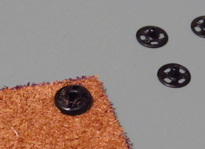

Now it is time to place 4 clothes latches on the leather and give them right place.
With pen draw small dots on the leather.
Step 4: Preparing Leather - 3
With scissors cut drawed before selected outer shape.
!! Be aware on your finger. This kind of knife is very sharp!!
If you are not sure if you can make it ask someone more experienced.
Now with knife cut internal window for OLED dispaly.
This can take some time depending on the thickness of the leather.
After all we will get open window inside of leather.
Now you can check if display can be seen through the cutted window.

Step 13: Sew Snaps to Leather - 1
In this step we are going to sew clothes latches to the leather.
Step 14: Sew Snaps to Leather - 2
Sew step by steps all latches. Be aware of your fingers because of the needle!
Step 15: Sew Snaps to Leather - 3
With scissors you can make round corner of the leather .
Step 16: Sew Snaps to OLED Display - 1
This step is similar to step 4. Now we are going to sew 4 latches to OLED display.
Mark on the leather position of the latches from OLED display.
Check if everything fit in to the right place. Snap to snap.
