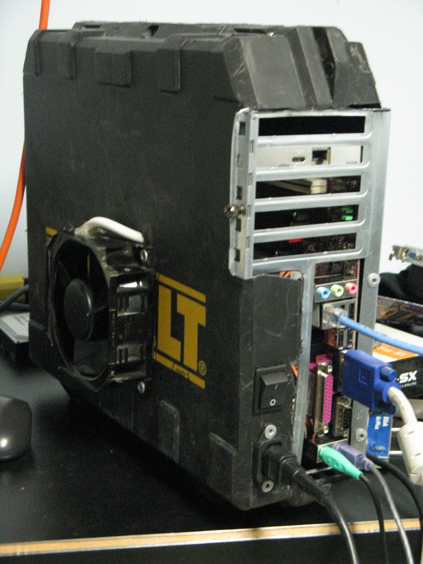

So this all started at about 6:45am (cause i was board and awake) anyhow I had a LAN party coming up and I was thinking about bringing my home stereo to the party but its kind of problematic with the really flimsy wiring. So I said (Hey I haz The P0wer of z Ethernet cable!!1!) *slaps self for typing in 1337* .... ok not like that but close. any how to show you what I did and how ....go to the next page! (just a suggestion) XD
