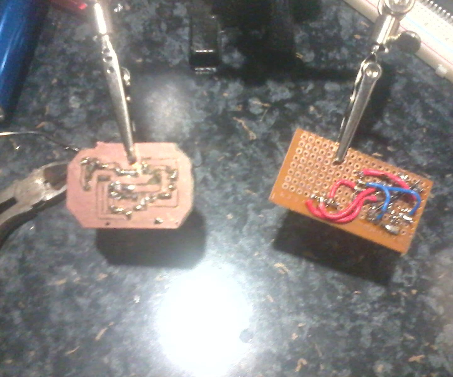

There is no general schematic because this is not actually a circuit but a bunch components soldered in perfboard.
The basic thing is that near every component there are some female headers breaking it out. The whole ZIF is broken out, the ISP connector is broken out to 2 headers per signal. There is also a resonator (Crystal-Capacitor system) slot with 2 broken out pins that go directly to the IC's XTAL pins (to use the external oscillator). The LEDs are used for the Arduino ISP sketch, which defines 3 LED signals: the Heartbeat (a pulsating LED that shows that the arduino hasn't crashed) - for that I use the Green LED, the Programming (this lights up when there is communication with the IC) - for that I use the Blue one, and the Error (lights up when an error occurs) - for that I use the bigger Red one.
When I want to program an IC, I mount it on the ZIF socket, I find the MISO, MOSI, SCK, RST, VCC, GND pins by the datasheet or google images (this is much much easier than it seems), **something optional here described below**, I connect jumpers from those pins to the ISP connector breakout, connect the ISP cable to the Programming Station and the PC, and I use avrdude or Arduino IDE to do my job nicely!
**If I want to use an external oscillator I locate the XTAL1 and XTAL2 pins, I connect the Resonator (only 3-leg resonators are supported - they are pretty common and cheap) to the special resonator slot and I connect with jumpers the broken out resonator pins to the IC's XTAL pins.
