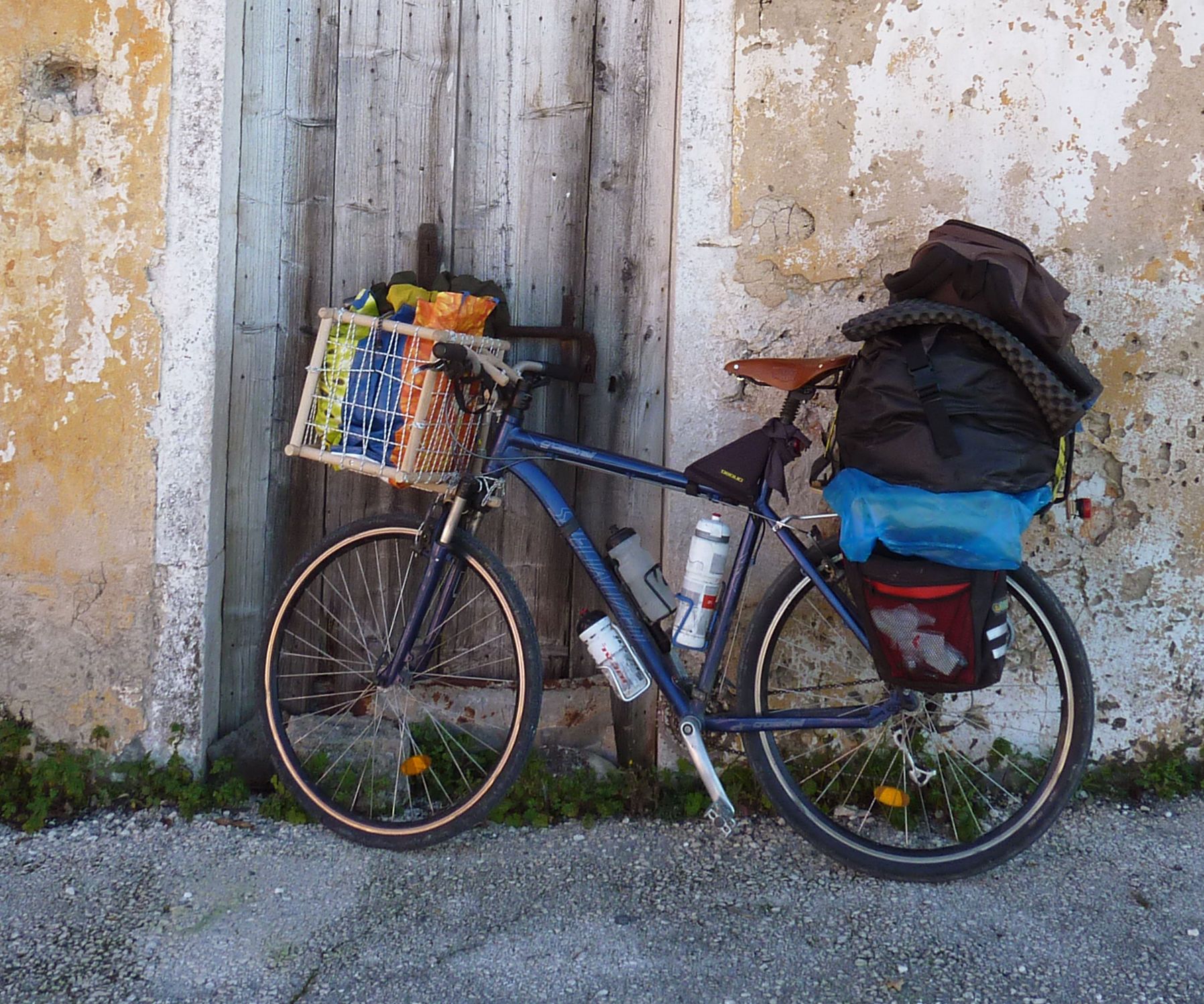

I have been using these leather grips for a week now and I can honestly say that they are amazing. And they look awesome as well. It's weird having strangers tell you that I shouldn't invest on my beat up bicycle, by buying expensive parts! They wouldn't believe that these grips are homemade with straight out of the bin materials! I ‘ve never had proper bicycle grips in my life. All I had was worn out bicycle grips or new very cheap ones. My DIY leather grips are my first proper very expensive looking grips. And I got them for free. Check bellow how I did it.
