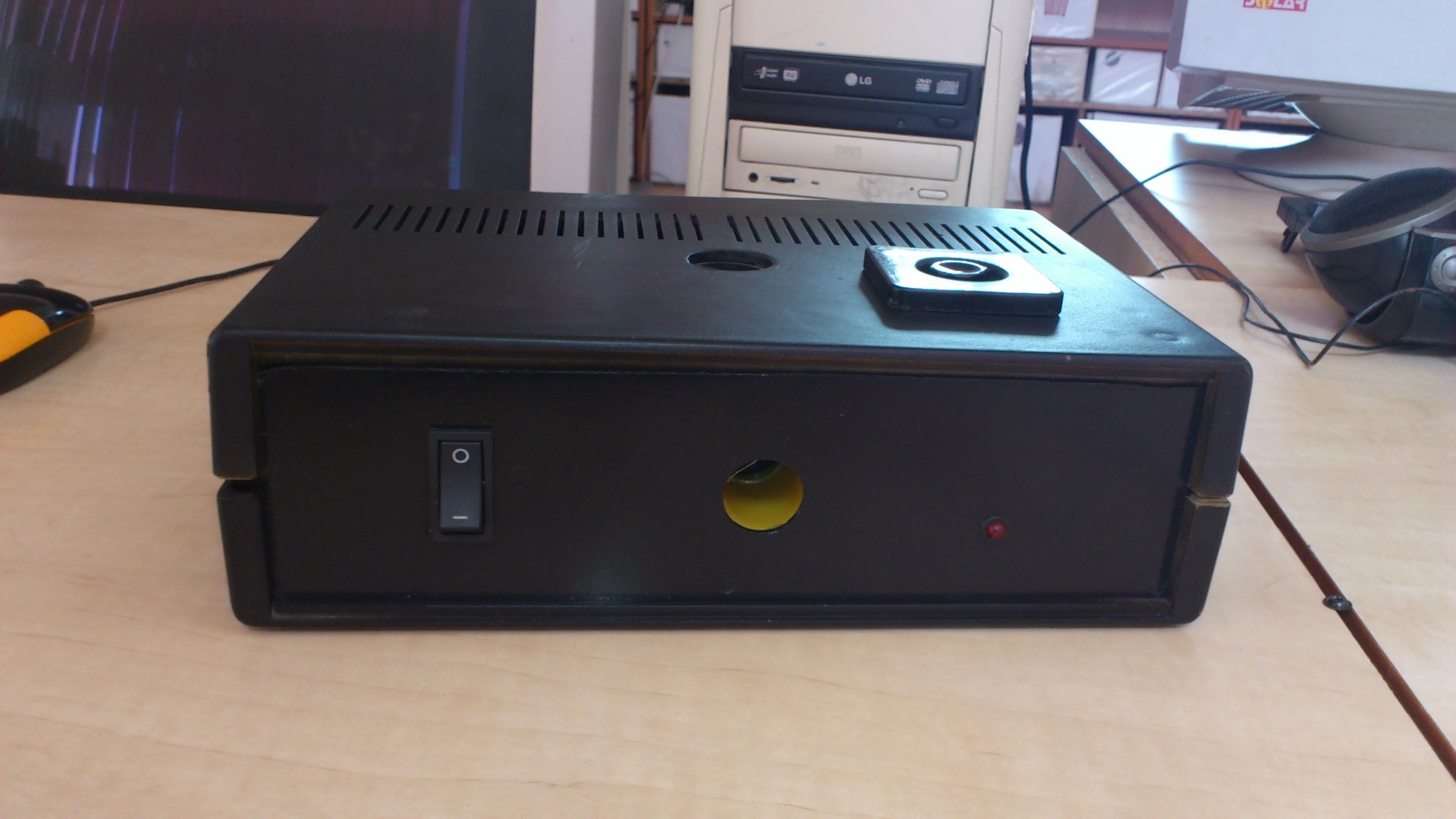

Step 4: Assembling the Pulse Magnetizer
I stick the coil with hot glue on the back of the front panel, and the capacitor on the bottom of the case.
I drill a hole through the top of the case and stick a piece of blue transparent plastic to see the light.
I stick a piece of plastic on a side of inner space from the coil because when you push the button of the switch, the magnet or the thing you use will be throw out, depends of the size of the thing. If you are touching the thing while you push the button, you will feel the pulse passing through the thing. Stick it as good as you can, because little things like nails can detach your plastic.
I stick the DPST switch and the PC power supply jack of their panel putting hot glue among them.
I drill a hole through the top of the case for the push button switch.
I stick of the bottom of the case four pieces of rubber which can be found on the bottom of a keyboard to increase the stability of my device.

Step 5: How It Works
The diode D1 rectifies mains voltage and charge the capacitor via the lamp (which limit the current).
The lamp glows during the capacitor's charging. The light is diminishing as the capacitor is charging. When the capacitor is charged, the lamp is off.
After few seconds the capacitor is charged and the light goes off.
By pushing the S2 button, a pulse of high current (aprox 50 A) passes through the coil magnetizing the object placed inside the coil.
This process can be repeated.
The magnetizer is simple, effective, made from salvanged parts.
