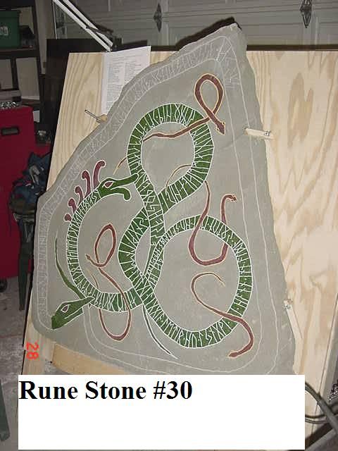

The great thing about making your own paint is it gives you a holistic feel for something you've done. When I finish a rune stone and know that I raised it from the ground, carved it and painted it, it puts me directly in touch with my own history. Like all DIY projects there is a level of satification in in your own craftsmanship that you really can't get any other way.
Now give it away, inspire somebody else, if you like them a lot give them a little thing that they can keep with them, if you don't like them make the project absolutly beautiful and spectacularly huge and heavy.
This stone was a memorial to a friend who passed away a couple of years ago, it went to Pensic War out in Pensylvania and then spent time with her family, I carved it out of Tennesee slate which is like carving glass, you don't get to many oops'. I'm told that it brought some smile to peoples faces who hadn't smiled since she passed on.
