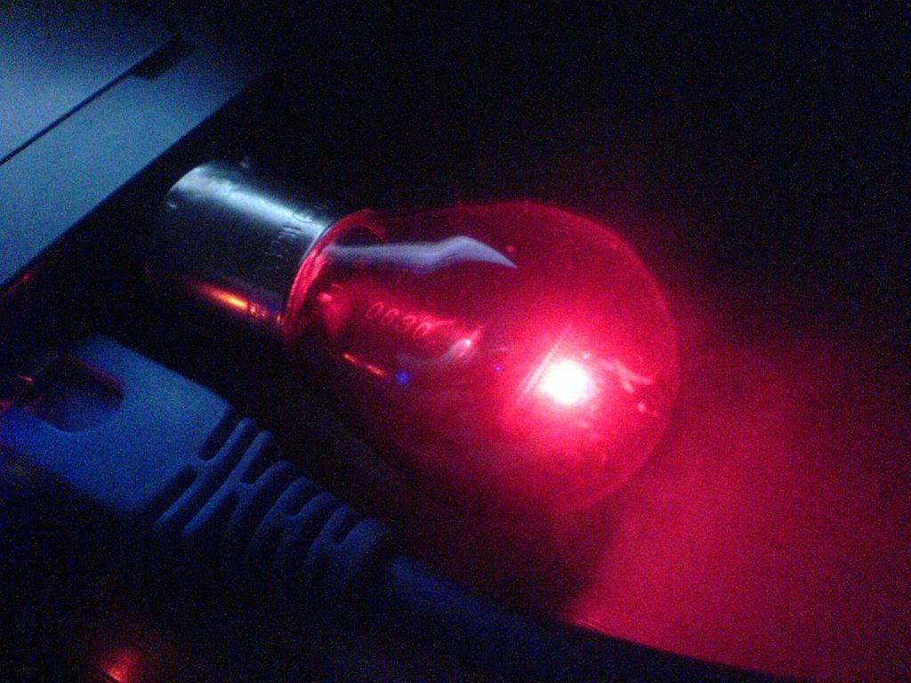

Step 8: Saw the Glass Bulb and Glue It
OK, still needs a little bit! This step is the hardest!
Take the glass bulb and wrap insulating tape around the bulb where you have determined at step 2. The tape will help you to cut around the glass bulb with the engraving pen. Be patient and careful, you will have to cut around the bulb many and many times, slowly, in order to make glass more thin so you can separate the two parts. If you will be impatient, you will break glass!
When done, you can paste the empty glass bulb on the rest of housing, inserting memory drive PCB inside glass bulb. If memory drive have difficulty to enter inside the bulb, you can use a file to make thin the edges of PCB and bulb (where PCB and glass have contact). Again, be careful this time also or you will void the project! After that, you can paste parts together; I used universal glue from Pattex
Step 9: You Have Done!
After few hours you can use your own light bulb USB memory drive! See pictures for results
