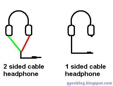

In this tutorial I’m going to show u how to replace a 2 sided cable headphone to 1 sided cable headphone.

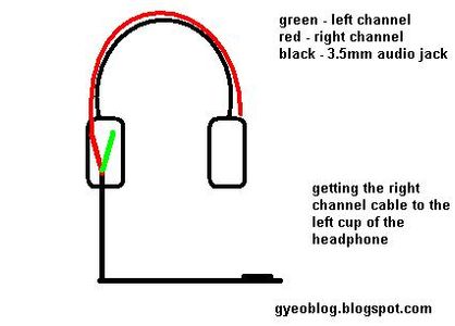

Here’s the plan:
We would need to get the right channel of wire across the headband to the left side of the headphone cup, and fix a brand new audio jack cable from the left headphone cup.

Now cut the long cable from the original headphone cable, which it is going to be use across the headphone headband to the left cup. Please cut a very very long cable, 50cm would be great. You will find out why you need a long wire later.

Removing the left cup of the headphone with the step above, cut all the wires ready. And now it’s time to get the 3.5mm audio jack and remove 1 side of the cable. Cut 1 side of the cable. You will notice there are 3 wires in the cable. 1 would be GROUND, LEFT CHANNEL, and RIGHT CHANNEL.
Now its time to solder the wires together and all the wiring will be need to insert into the left cup of the headphone. So, make sure all the soldering and wiring should be done so that it could fit into the space of the cup of the headphone.
I realize that there is no specific standard coloring of wires to determine the left, right and ground channel, so you have to do testing of your headphone and make sure you solder on the correct wires. You may download this free audio kit I made for the testing of audio channel. Test the cables if you have solder the right channels together before wrapping them up.
