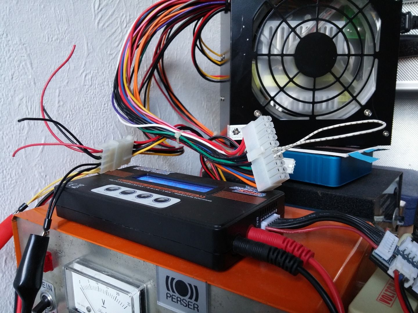

Introduction: How to Power Up an ATX Power Supply Without a PC!
In this instructable i will show you how to power up an ATX Power Supply without a PC.
Maybe in some cases you want to test an old CD-Rom Drive or something else.
All that you have is a PSU from an old PC an a wire.
Here I show you how do to it.

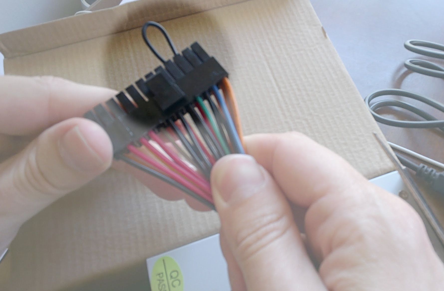

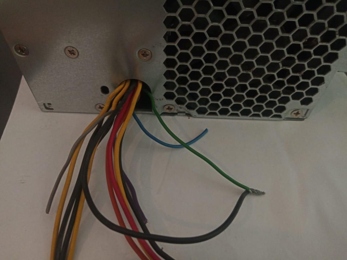

Step 1: Search!
Just look after the green wire in the cable tree from the PSU.
Follow it to the 20 or 24pin ATX plug.
The green cable is in a way the "reciever" you need to power up the PSU

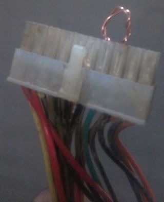

Step 2: Connect!
Now it's time for the wire.
Bend the wire and close up the little green plug from the big ATX plug to any other BLACK plug. Cause the black is the ground. To come off best you should connect the green with black besides the green.
Your PSU should power up immendiatly!
You are done!
2 Notes:
Use a thicker cabel for this. a standart one will cause a loose connection witch
isn't good for the PSU.
When you do this make sure that you have some device(s) connected to the PSU. Otherwise your PSU tries to drive the non-existing device an will overheat.

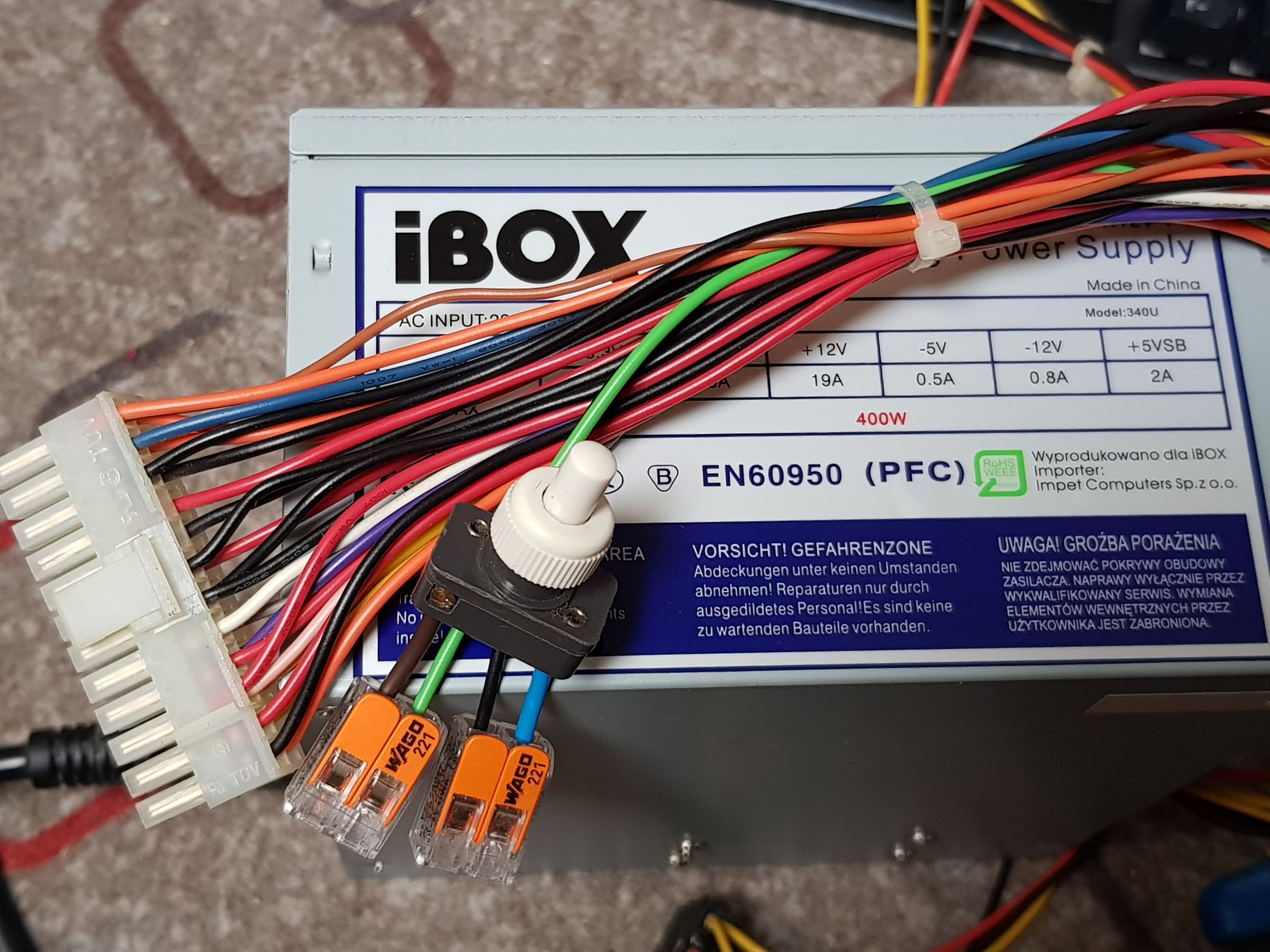

Step 3: Extra Options
Add a switch instead the wire!
simply bend 2 wires like I do in the pictures an stick them into the black and the green port of the ATX plug and the other ends into the switch.
Ready to go!

EdwinM73
EdwinM73
4 years ago

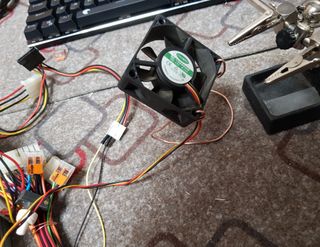

You missed something important for 24 pin PSU,s. i bet many had tried this and had their PSU just turn on for a second then turn off, If you have a 24 pin psu you MUST connect the brown cable to an orange cable "brown is the voltage sense" and the green to black ! Your 24 pin psu will now work as intended standing alone. Additionally for stable and correct voltage you should also have your psu under 10% of its rated load from startup, i.e. if you have a 750watt psu you should have 75 watts of load minimum, you can just use a Panel Mount Fixed Resistor say 50 to 100 watts, again the psu will turn on with out load but may not give the exact voltages you desire. Hope i helped you all : )

The power supply probably needs to see some kind of load. Try hooking up an old cooling fan from a old case as a load.
