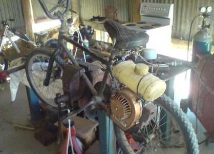

This Instructable will show you how to modify your push bike with a small motor so you wont have to pedal as much and look a whole load cooler! I made mine using a really old kawasaki whipper snipper (weed whacker for you Americans) motor. I could get about 40kmh along a flat with no pedalling and an easy 55kmh down a slight slope, I could go faster than traffic!

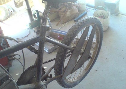

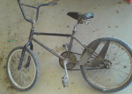

  • a bike (any will do, but the simpler is best ie. no rear shocks and stuff because it just complicates things, although still possible)

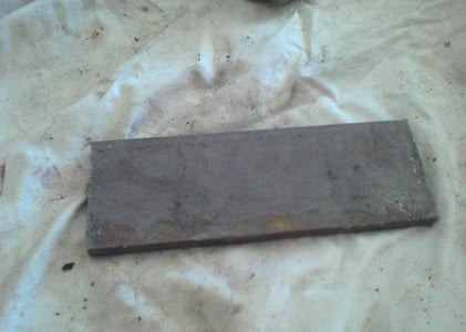

  • a bit of thick plate to use as the mounting plate/bracket. thick stuff is good because it hold your motor nice a steady.

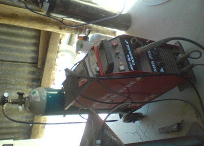

  • welder

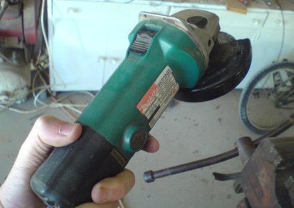

  • grinder

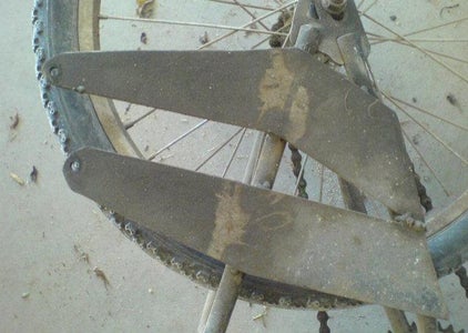

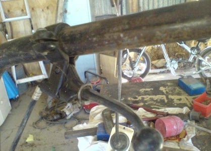

Step 2: The Motor Mounts

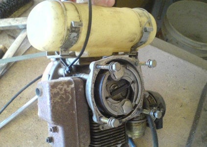

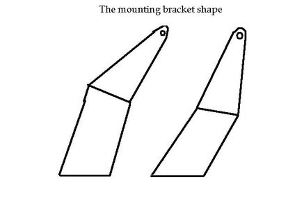

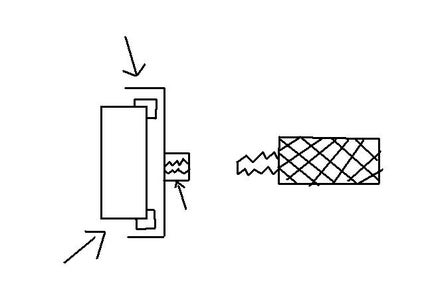

This step involves making the mounting brackets for the motor, this is probably the most crucial step and also the longest, not because of the fabrication (takes bout 30mins) but the thinking and fiddling around. This took me about about an afternoon and night wondering whether I needed more or less or stronger supports. I then just came up with a 2 support plan and stuck with.
it basically would hold the motor by the 2 bolts that also held the clutch on and in its previous life (as a functional whipper snipper, the wire stand). I forgot to take a photo but its pretty simple.
Threes so many different bike shapes and motor mounting designs, so I'm not going to tell you how to do yours, (unless yours is same as mine) so you'll have to figure out the shape and/or mounting style for your bike/motor.
when you have your motor mounts ready to be fixed to your bike. you should just "tack weld" them on first because you will probably have to adjust them as you want a fair amount of pressure from the drive shaft onto the wheel but not too much that it hard to turn.

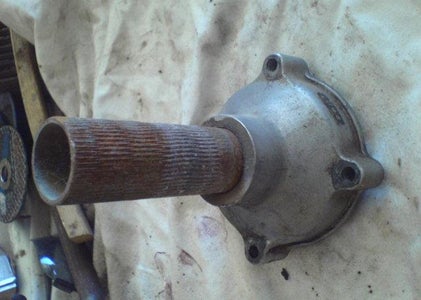

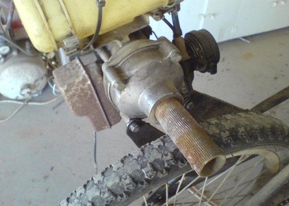

Step 3: The Drive Shaft/roller

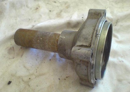

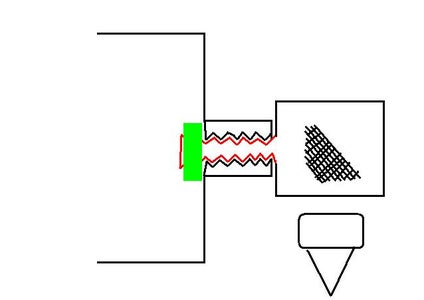

this is the piece that transfers the power from the engine to the wheel. I had lots of ideas about this, including using bike pegs, making my own, scooter wheels etc ( I saw someone use a socket and it slipped against the wheel and didn't work at all if he went through a puddle)
I had sum bike pegs I was going to use but they had imperial threads and my clutch used a metric thread and I didn't want to make an adapter so I decided to make my own.
I needed a lathe to make my own but so dad knew a bloke with one and he made it for me. it fit nicely into my clutch housing and threaded right into it.
the size of the shaft/roller matters as it affects the gearing of you bike. you will need to work out revs of your motor, size of your back wheel, how fast you want to go etc, to decide on the size of the roller.

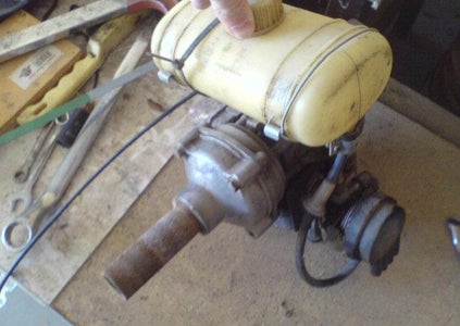

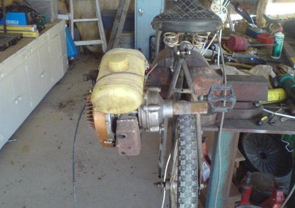

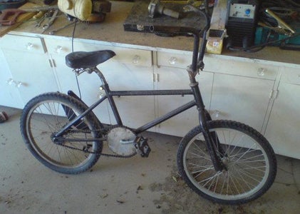

Step 4: Mounting the Motor
this is the most satisfying step as u can see the bike starting to come together. it is also the easiest step if you have done everything else correctly. (i had luckily done everything correclty and it went together like a charm) this is simply bolting the clutch to the motor to the mounts and it shld all line up.
if you motor is sitting at an angle to the bike this is wen you may need to heat your mounting brackets and give them a bend to make it sit straight. or if u really screwed up, u can cut the mounts off and reweld them straight.
make sure that if you are holding the bike in a vice like i was that the bike is the same level as if it was sitting on the ground!. mine was tilting back so when i leveled the motor and then sat it on the ground the fuel tank was leaning back and i had to chock it so that the fuel would flow throught the tap.

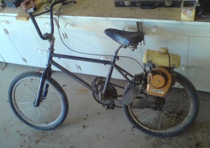

Step 6: Riding
This is the fun bit. If u used an old motor like mine that is very unreliable and crappy, it would be best to carry out some maintenance on your engine. Also unlike me it would be wise to put brakes on your bike!!! I got quite a scare going into a busy intersection with thongs (flip flops, sandals) as my only brake.
Also check the legality of these kinds of mods, in NSW, Aust, to be legal it must be under 800watts of power and under 25cc or something. I’m sure cops would love to book someone causing trouble on a motorised pushbike.
My bike when the engine was running nice did 40kmh easy on flat. I put nitro fuel (15% nitro methane, the stuff used for R/C cars) in it one day and it went ballistic, it scared me.
The clutch on mine wore out pretty quickly coz its old n I’m heavy n didn’t want to pedal at all. But if your light or have a more powerful motor u don’t have to pedal ne time except for start off and really steep hills.
