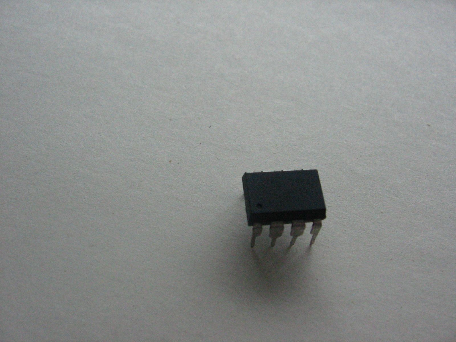

- Raspberry Pi(any)
- Some jumper cables(pins to breadboard)
- one gpio pin(optional, but it makes your life simpler)
- Breadboard
- ATtiny(25/45/85)
- maybe 4 x 400 ohm resistors(to avoid errors)

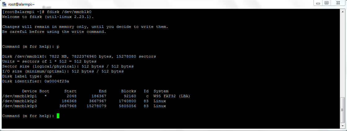

I used Arch Linux on my rpi
Now do the following commands:
I MADE STUFF EASYER FOR ARCH LINUX USERS, YOU CAN USE YAOURT NOW(yaourt -S avrdude-rpi)
[mark@berryterminal ~]$ sudo pacman -S bison automake autoconf flex git gcc
[mark@berryterminal ~]$ sudo pacman -S avr-binutils avr-gcc avr-libc
and clone custom avrdude from https://github.com/kcuzner/avrdude
[mark@berryterminal ~]$ git clone https://github.com/kcuzner/avrdude
[mark@berryterminal ~/avrdude]$ ./bootstrap && ./configure && sudo make install
