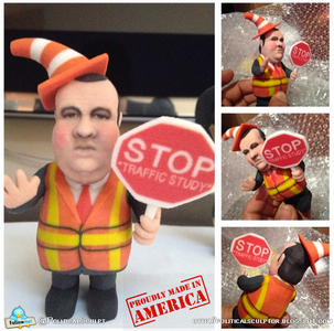

Here is the link for the Large 5 inch  Figurine
https://www.shapeways.com/model/1674852/chris-christie-directing-traffic-bridgegate.html
here is the link for the medium 3 inch figurine
https://www.shapeways.com/model/1725900/small-chris-christie-directing-traffic-bridgegat.html

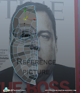

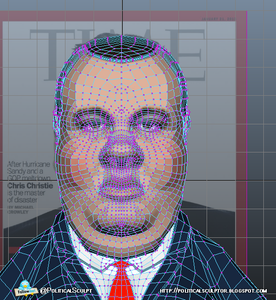

Pretty much anyone can make a 3d scan of an actual person. anyone can make a 3d model character.. So i wanted to make something that made it clear it was chris christie when you see it... SO it needed to be accurate but still funny.. Pretty much think about it as a political cartoon in 3D.. I had to summarize the whole bridgegate in a 4 inch figurine (2 1/2 inch also available)
I didnt do much sketching on this figure because i already had the mental pic on my head.. So i just had to get Chris Christie's face right.. i found like 20 reference pics and started to model..
i'm only posting some reference pics for copyright issues.. so dont think i only used 2 images..

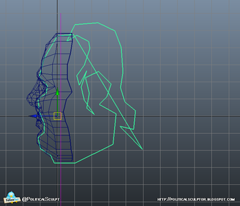

After many late nights i finally had the model done.. Which believe it or not was the easy part..
Making the model watertight, with clean geometry, non manifold, etc etc is the hard part.. ONce your model is done you might think is over right? WRONG..

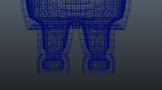

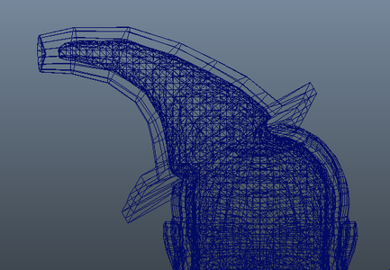

Step 2: Reduce the Cost of the Print by Hollowing Out the Object
uploading the model to shapeways this way would cost you about 80 bucks to print... because they charge you for the amount material used.. So all the infill in the figure increases the cost exponentially..
in order to reduce the price of the print you need to hollow out the object yet leave a minimum 2mm minimum of thickness for the entire object.. This is extremely hard and complicated especially if you have complicated geometry..
Anyways once hollowed out.. the price is reduced exponentially.. this went down from a 80 dollar action figure to 37 bucks!!..
If you are new to 3d printing.. 37 dollars for a 5 inches tall figurine is freaking good.. Stuff like this used to cost hundreds of dollars.. This new technology is amazing.. So be thankful prices have gonne down this much.

So in order to make this affordable enough that a new jersey teacher might be able to afford i went back.. i reworked the model and spend a lot of time and reduced the size from 5 inches down to almost 3 inches.. So you can now buy this 3d Printed Chris Christie "bridgegate" action figure for 25 bucks instead of 37 bucks..
Now everyone can own the very 1st political oriented 3d action figure in the world!!..

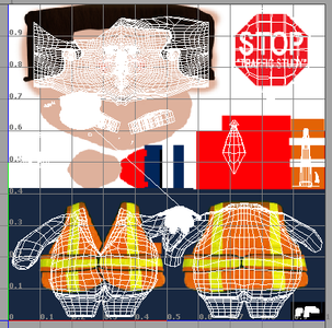

Step 3: Texture Your Model and Export It Correctly
When i 1st got into color printing i had no idea of what to expect.. i was hoping i could use separate lamberts with different colors in order to color certain polygons a different color.
However, The only way to get the colors to print correctly is by using a texture file and stretching and laying out the UVs.
This process done for gaming, movies etc.. This process gives you a lot more freedom with texturing your model but is a bit more complicated when it comes to texturing an object
One of the greatest advantage of such process is that you can paint or use photo images to create the textures.. So i created a stop sign texture.. found a construction best texture made my cone head texture.. etc..
The trick is to keep textures at 1024 pixels, 2048 pixels etc... if you don't it won't get recognized by shapeways.. your final product must be a .WRL file for your model and a .JPG file for your texture.. compressed into one file..
So if you modeling software doesn't export .WRL file.. you need to export it as an OBJ file.. and use Meshlab to export it into a .WRL file..

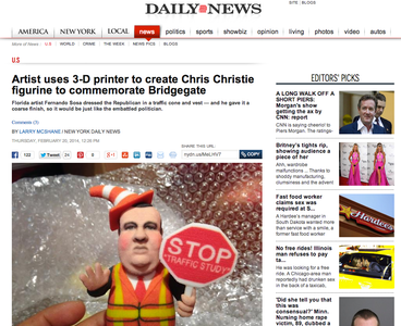

It was posted on the Star-ledger at NJ.com
http://www.nj.com/politics/index.ssf/2014/02/photos_orlando_designer_creates_christie_bridgegate_doll_with_3-d_printer.html
The Trentonian
http://www.trentonian.com/opinion/20140219/jeff-edelstein-3d-printing-gives-us-the-chris-christie-bridegate-in-action-figure
New York Daily
http://www.nydailynews.com/news/national/chris-christie-figurine-commemorating-bridgegate-article-1.1621117
Salon.com
http://www.salon.com/2014/02/20/chris_christie_update_guv_buddies_up_with_wal_mart_and_readies_for_his_first_post_bridgegate_town_hall/
Channel 12 News!!
https://www.youtube.com/watch?v=VYLm7bKR4ww
and MSNBC's Hardball
http://www.msnbc.com/hardball/watch/bridgegate-action-figures-appear-in-nj-162476099994
