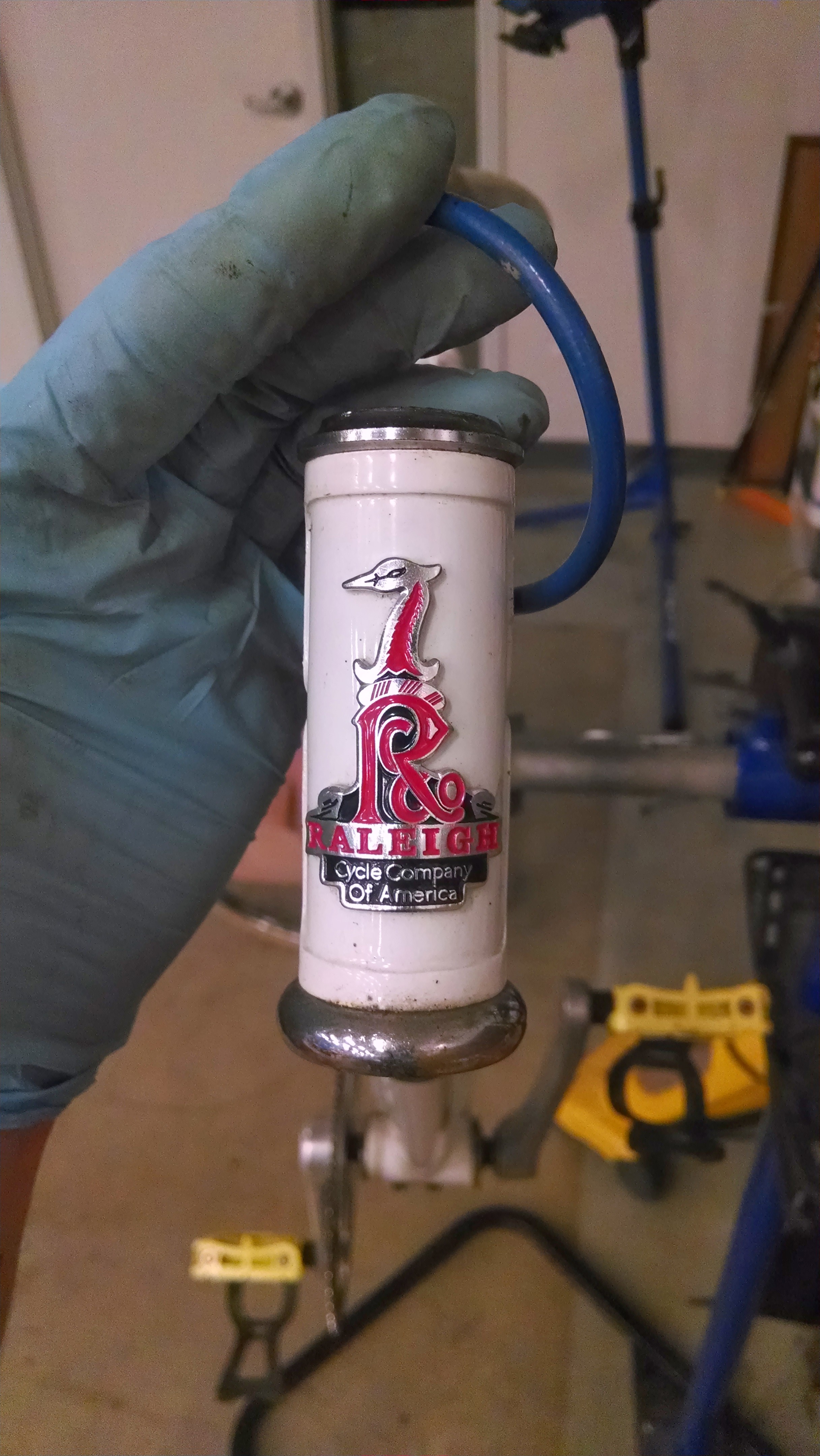

Step 1: Get in There!
Once you have the wheel off your bike and the skewer (if you have one) is out of the axle, you'll want to loosen up one side (it might already be loose if your wheel was a little wobbly) and take the lock nut, any spacers, and the cone off. There might be a dust cover underneath. Mine has one. You can just gently pop it out with a wrench, knife, toothbrush, comb, key, toothpick, fork, bullet, used tungsten electrode, etc.
The axle is not held in with anything except those cones, so once you start to loosen them up, the bearing balls can fall out. The dust cover helps, but not all hubs have them and even with them the balls can fall out. You'll want the wheel sitting on the table while you do this so the axle is always pressed into the hub.
Step 2: Getting to the Bearings
Once the nuts are off one side, the axle will fall out the other side. Be careful with this and do it over a towel. The ball bearings might (probably will) fall out and if they hit anything hard they'll bounce to kingdom come and you'll have to sweep your workspace for days before you find it.
The nuts on the other side of the axle do not need to be removed, so it's a good idea to take your cone wrench(es) and tighten the cone and nut together to make sure they stay put when you reassemble the hub.
