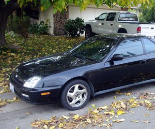

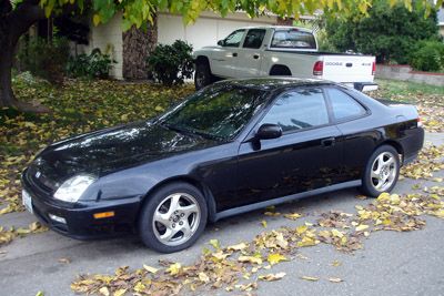

I recently bought a nice 5th generation Honda Prelude with tinted windows. I always liked the way that tinted cars looked, but didn't think it was practical because most of the driving I do is at late at night. The new car also had radio reception problems. The antenna in my car is a thin wire layer on the back window above the defroster lines. Asking around I learned that the tint in my rear window was likely causing my poor reception (it was). These two reasons drove me to removing the professionally installed tint the car came with.
After calling a tint shop and getting a quote of $140 to get the 5 window (2 doors, 2 rear quarters, and rear window) tint removed I decided there had to be a better way. I did some research online and prepared myself for a messy painful process. It turned out to be easy, so easy I figured I'd write it up for you.
The advantages of this method are that you do not need to cut the tint off at all (no razorblades = no mess) and so it is safe on your rear window without any fear of messing up your rear defroster or antenna lines. The method is also significantly faster, cleaner, greener, less messy, and less hazardous to your health.
General idea:
The goal here is to steam the window and tint so much that the glue releases itself from the window. Then all you have to do is slowly pull the tint off of the window (as you continue to steam) and the glue comes with it - no mess!
