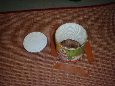

Step 1: Preparation

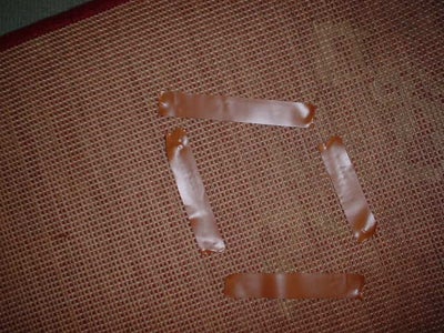

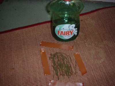

Mark the affected area on the reverse of the rug, I've used tape but a marker or chalk would do. I guess you could push pins through from the front if it's difficult to judge.
Apply a little detergent to this area, which should help wet the fibres and allow water to penetrate rather than roll-off.

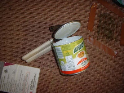

Using a can-opener, remove the other end from a empty can (sweetcorn in this case) to give you a steel ring. This will help guide the hot water you are about to apply to the back of the rug.

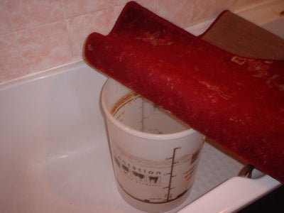

Place the rug over a bucket, preferably in a bath or over a surface which will not be harmed by water. Level and flatten the rug on the bucket. In this position water should be inclined to move straight down, rather than to one side.

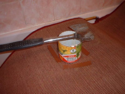

Weight the ring made from the can over the marked area with a heavy object of your choice.

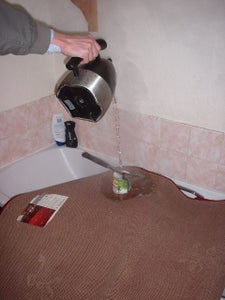

Pour hot (just boiled) water into it - see picture - be careful and notice from the second picture that I'm keeping at arm's length away from the water.
I used 1.5 Litres, and it would have been ~95oC.
Some of this escapes to the sides, but a high-handed, rapid pouring drives hot water into the rug, splashing is contained by the ring and detergent-foam.

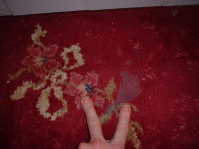

Step 3: The Results

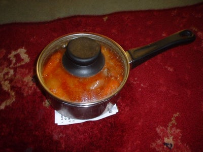

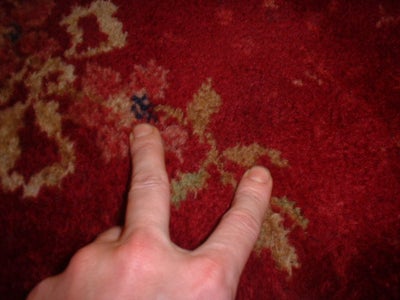

This was almost totally effective first time. A tiny amount of wax left behind was easily removed with some paper and a hot pan of curry goat.
As documented elsewhere, place a sheet of absorbent paper over the waxy area and apply heat with pressure, the function of a hot pan should be obvious.
One other remaining patch required two hot water treatments, but was similarly removed.
