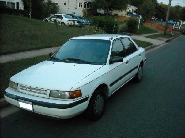

The other day my brother bought this civic from a local dealership. I checked the car in great detail on and off the lot and I discovered that the car had a bad valve stem on the spare tire.
