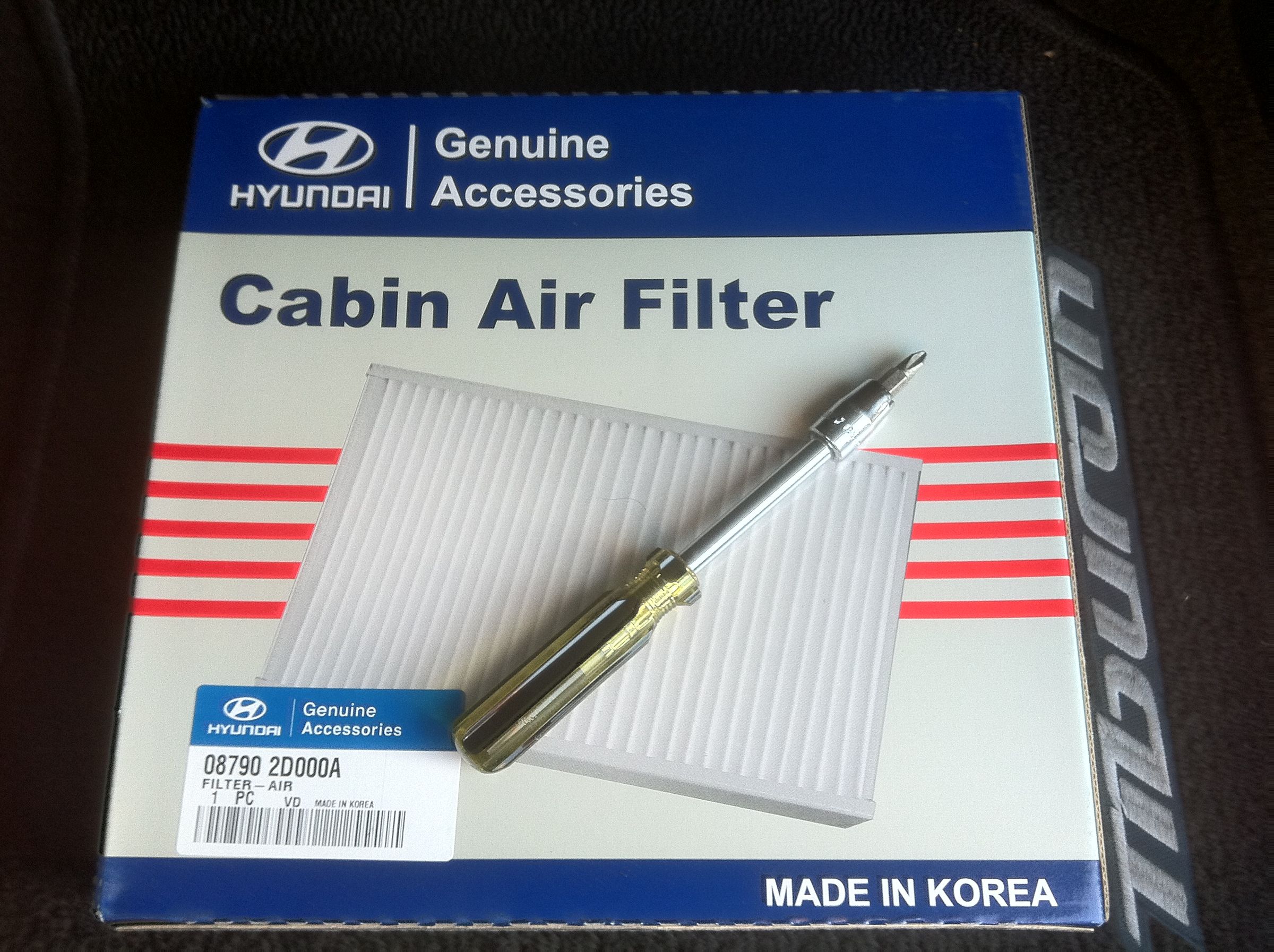

This is a fairly simple task of replacing the engine air filter in the 4 cylinder Hyundai Tiburon. The engine air filter keeps dust and debris out of the engine and prevents premature wear and tear. It can get clogged and reduce performance and fuel economy if not replaced regularly. How often depends on your environment but I usually do it every year cause it is easy and cheap. Check out the maintenance manual for specific time/mile intervals.
All you need is the engine air filter which is readily found at most auto parts store as well as the dealer. No tools but your hands are needed.
