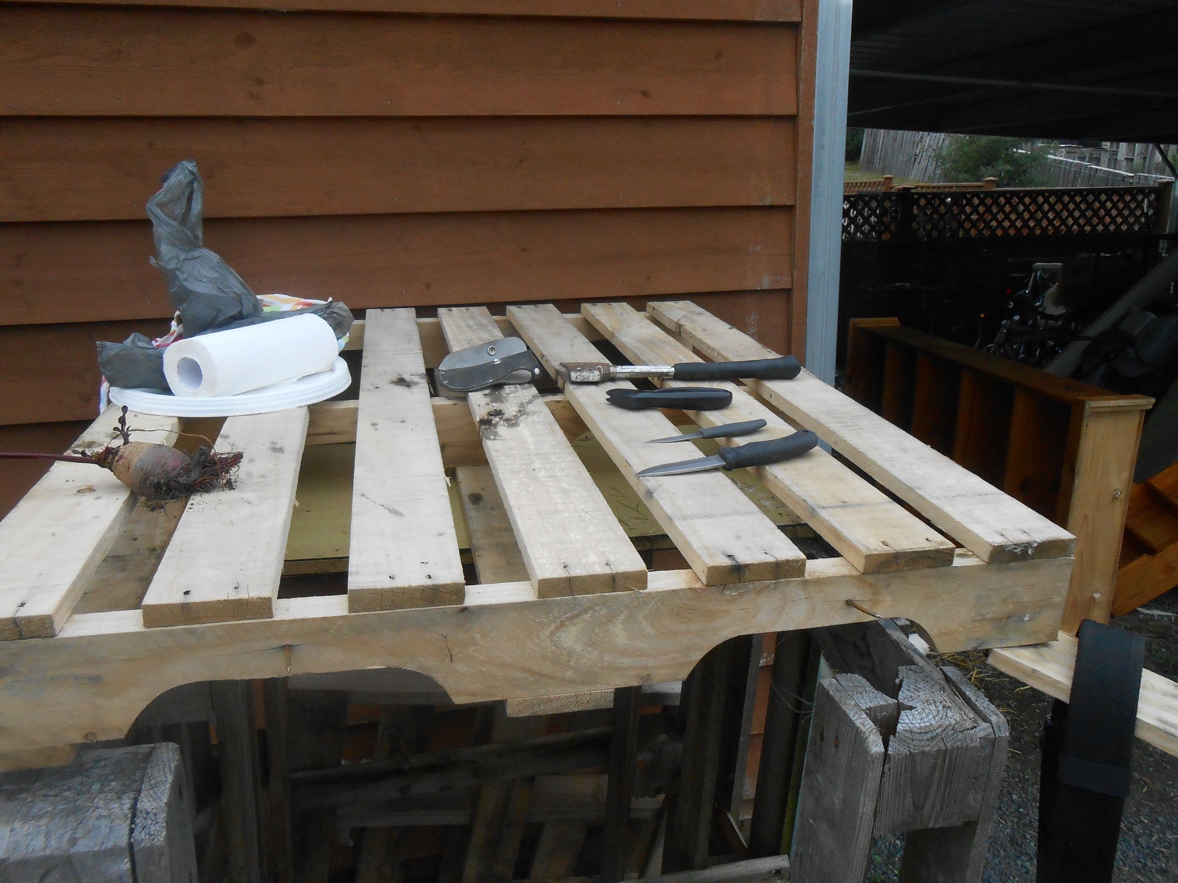

The tools required.
A reliable Tape measure - You need to take the measurements in order to buy some new glass.
Paint scraper - This is to remove the Sash and any glue
Stanley Knife - To cut the Sash free from the frame.
Hammer - to Hammer the Sash nails back into the frame.
Thick Gloves - to protect your hands from broken glass.
Safety Glasses - to protect your eyes. Hopefully you will not need them, but better to be safe.
