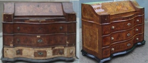

With this article i want to explain set by step the restoration process of wooden furniture.
Restoration is a world that offers endless possibilities for our old furniture and gives second chances to antique pieces full of charm and personality. i will proceed to

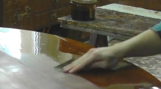

Step 4: Varnish
It is the final touch on wood surfaces. Several types of varnish (colorless dye ..) that allow us to obtain different finishes and increased protection on the wood. Thus varnish application will vary depending on the type and condition of the surface we are dealing with. In this report the steps to take for each situation (new surfaces, shabby ..) are explained.
The varnish is a completion or finishing of wood that allows us to obtain interesting results in any carpentry work. It is very important to choose the type of varnish you want to use and , of course , know the type of surface on which to apply and the state of it. Depending on these factors , we must follow a few steps or other .
Whole new area The woods that have not been treated to never follow a preparation before painting. once varnished completed all phases , a wood will be achieved with a very attractive appearance.
1. The first is to mix and smooth the surface with sandpaper number 00 or 000 . Always have to sand following the grain of the wood.
2. Remove dust produced by sanding with a soft brush.
3. Applies a firsthand insight. Do varnish diluted with turpentine.
4. Then given a coat of varnish . Let dry at least 24 hours and apply a second coat.
