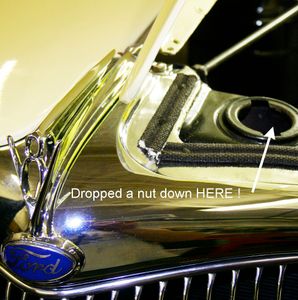

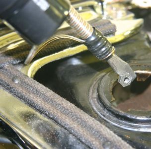

Have you ever dropped a tiny screw or nut into a location that you just can’t reach? Well, I did. While working on an antique car, being a ‘klutz’, I accidently dropped a small nut down the radiator. I could see it, but I could not reach it. A definite “dooh!” moment. I tried tweezers, pliers, and even sticky tape on the end of a screwdriver, but nothing worked. I needed a magnet, but did not have one. So, I made one. This Instructable will show you how to make your own electro-magnet (a tiny one) that will pick up the wayward nut.

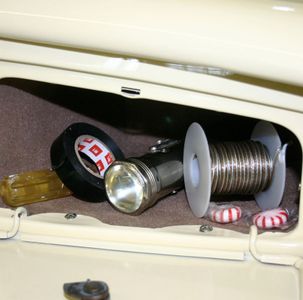

Looking in the glove box, I found a flashlight, a roll of electrical tape, some left over speaker wire from a speaker installation, a screwdriver, and a few old mints.Throw out the mints. They are probably petrified.
Remove the batteries from the flashlight. This one had ‘D’ cells. A large battery like a ‘C’ or ‘D’ cell works best. I have not tried this with a smaller battery, but that would be a good experiment.

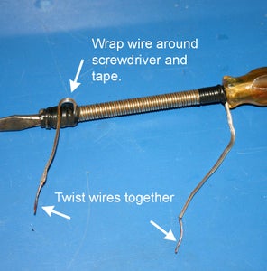

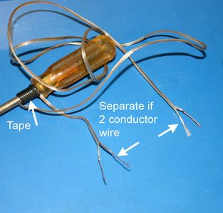

Cut off a piece of wire about 2-3 feet long. If it is a multi conductor wire like the 2 conductor speaker used in the pictures, strip back the insulation about 1 inch and twist the conductors together. Do this on both ends of the wire. Be sure to leave the wires bare on each end. You want to end up with the equivalent of one single length of wire with each end bare. If you have a single core wire, just strip each end.
Wrap one end of the wire a couple of times around the screwdriver and secure it with tape to the screwdriver, next to the handle, just to keep it in place, leaving about 2 inches free.
Step 3: Finish Your Electromagnet
Tightly wrap the rest of the wire around the shaft of the screwdriver almost to the end. It does not matter which direction you wind the wire and you can go back over the first layer if you end up with more wire than screwdriver. Leave about 2 inches free on this end and tape it down to the screwdriver like you did on the other end. The tape just keeps it from unwinding itself and then you have to start all over.

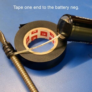

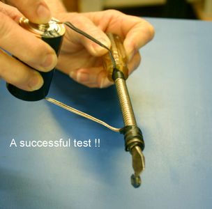

If you would like to test your new electro-magnet, now is the time. Find a little nut about the same size as the one you dropped. Tape one end of the bare wire you wrapped around the screwdriver to one of the terminals of the battery. I found that it works best if you tape the negative end. That’s the flat end without the little bump.
Hold the other end of the bare wire to the positive end of the battery while you touch your little ‘test nut’ with the tip of the screwdriver. You have completed the circuit, which turns the screwdriver into an electro-magnet and will pick up the nut. As long as you hold the wire to the battery, the ‘magnet’ will hold the nut. When you release the wire, the circuit will be broken and the nut will be released.
CAUTION!:
Please be aware that while you are holding the wire to the battery, current will be flowing through the wire. This will create heat in the wire, so hold it on the battery for only a few seconds, just long enough to get the nut out of harms way and does not fall off. It will just get warm to the touch since it is only 1.5 volts, and will run down the battery if you hold the wire to the battery too long.

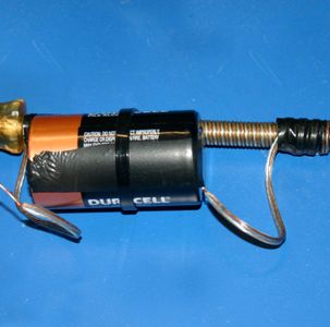

I found it easier to use if I held the battery to the screwdriver with something besides my hand while I took the pictures, so I used a zip tie to tightly hold the battery to the screwdriver. You can use tape just as well. This will keep you from 'fumbling' around with it.
Step 6: Go Fishin'
Take your newly made electro-magnet ‘glove box gadget’ to the scene of the crime and repeat the same thing you did in the test. Touch it to the dropped nut and it will be picked up with the magnet. Just be careful not to release the wire too quickly or knock your little nut off the screwdriver before you get it to a safe location. Please note that this will only work with steel items. Aluminum, brass, copper, stainless, or other non-ferrous metals cannot be picked up with magnets. In order to pick up those types of metals, you will have to find comething else in your glove box --- like some bubble gum.
