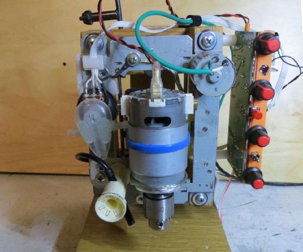

So I was fantasizing that I would build a robot that would do that for me. It's actually not impossible with todays technology, but it's a major research project.
