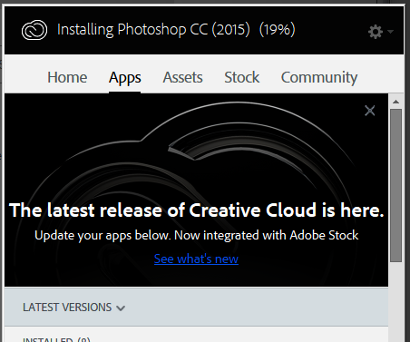

My solution and what many people may find easier is to roll back to the previous version of Photoshop, but it is not very clear how to do that in the CC dashboard.
Step 1:
Well the procedure is not that hard. And it is as follows
Open the creative cloud dashboard and go to the "apps" tab.
Step 2:
Then scroll down to the "Find additional apps" section and change the drop down menu on the right from "all apps" to "View Previous Versions"
Step 3:
Once you select that you will see the list of all the applications and is you click on the arrow next to "install" it will open a menu showing the available versions of each app. Select the one you want to install and that is it.
You are able to hopefully keep working normally until Adobe fixes its bugs.
