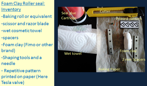

Step 1: Inventory
Everything you need:
-scissors / razor blade / carpet cutter
-Clay modelling tools and a needle
-wet cosmetic paper towel
-a roll (here an adhesive cartridge) and baking paper
-metallic spacers
- prior to this having defined a repetitive pattern (that will be repeated along one dimension, for instance the length)
---> here this is illustrated by a Tesla Valve)
and time

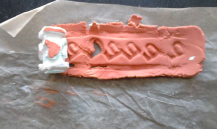

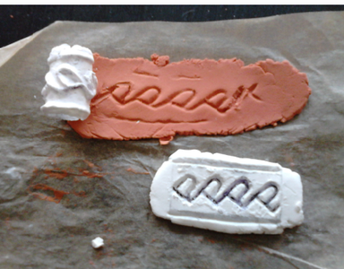

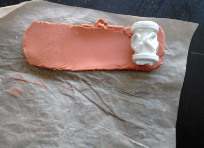

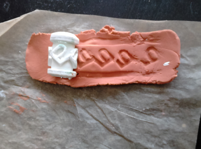

Step 2: How the Roller Seal or Roll Casting Method Works!
on the given picture you see the two roller seals I prepared, the standard one and the casted one.
you see what you can obtain by using a roll casting method.
Be careful you need to press firmly but you need to avoid overdoing it !!!
otherwise you will destroy the shape. Which is not dramatic because you can beginn again.

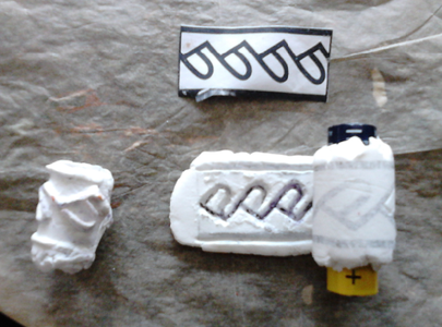

Step 3: Making the Standard Roller Seal- Part I-
1) prepare a 2 mm thick sheet with a length and a width corresponding to the pattern dimensions
By the Way: The perimeter of a AA battery is about 47 mm so the lenght of the repetitive pattern must be the same.
2) Place the printed piece of paper on the fresh foam clay sheet which has been wetted with the wet paper towel.
3) Press gently and wet the paper piece as well and then remove it. The pattern is transferred on the clay foam sheet
4) Cut off the whole blank part
Step 4: Making the Standard Roller Seal- Part II-
1) Place a small piece of baking paper over the shaped piece.
2) Prepare a sheet of fresh foam clay and press gently on top of the shaped piece.
3) Press a AA battery over the clay and 4) roll the clay around the battery (keep the baking paper while you are rolling it. it will help keeping everything together)
5) cut the clay to get a closed circle accordingly
6) let this dry overnight and remove the battery

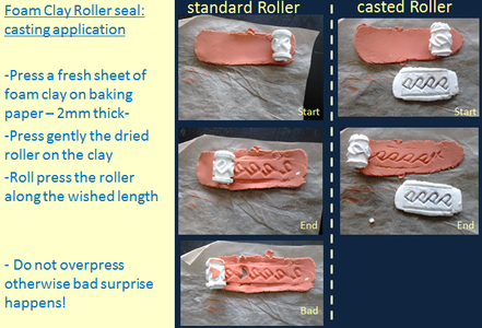

Step 5: Making the Casted Roller Seal
-Prepare a straight clay sheet 2 mm thick, transfer the pattern over this sheet and carve the black part off. (instead of the blank one in the standard method). and let it dry overnight-.
you will obtain the template for casting the roller
-Here you need to roll a 2 mm clay sheet around the battery
-Roll press the battery+ clay over the template.
and let it dry overnight.
That's all folks!
