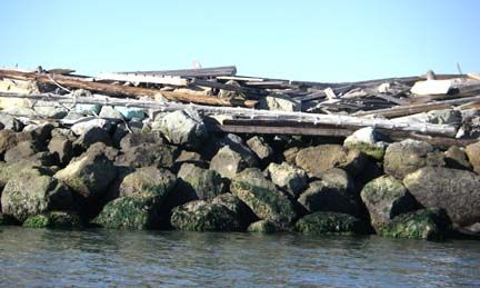

So if you want a better selection of lumber, you might want to look to break waters and remote locations inaccessible from land or from the water in conventional motorized boats. The kayak is the ideal craft for getting at this lumber. It has a shallow draft and can be landed on the beach. And surprisingly, even though the average human only operates at 1/7 horse power, you can tow some fairly large pieces of wood behind a kayak. Because lumber is long and thin, it slides through the water easily.

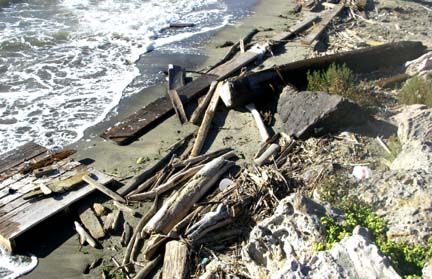

Once you have a kayak and the desire to scavenge wood, you need to go out and find some wood. If you are a kayaker, you will probably be paddling around anyway except you will now be scanning the shoreline for telltale signs of sun bleached wood gleaming in the sun.

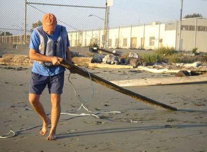

Once you have located the piece of wood you want to take home, drag it down to the water, close to the boat.

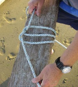

Now it's time to attach your towing line to the piece of lumber.
A series of hitches will do the job. These tighten up as you pull on the rope so they are not likely to slip off.
Attach the line about a foot and a half from the end of the board.

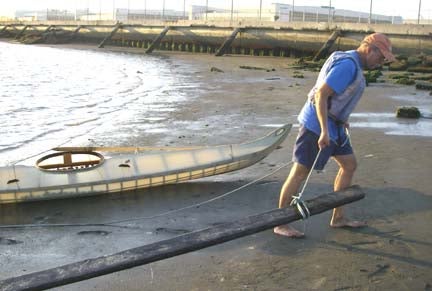

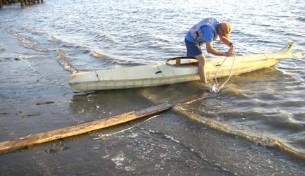

Tie the other end of your tow line to the boat. Use a slip knot so you can easily unhitch the lumber in case it starts endangering your safety.
The idea is to have enough line out so the lumber doesn't interfere with the paddling but not so much line that the piece of lumber is out of sight and can get tangled if you have to paddle close to obstacles and can't see what your lumber is doing.

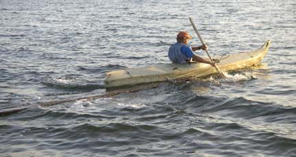

Towing a piece of lumber is not overly difficult. Chances are that if you have the strength to move the piece of lumber to the water, you also have the strength to tow it. Once in the water, the lumber floats so that you are no longer working against gravity. And as long as you haven't tied the lumber so you are dragging it through the water sideways, it offers relatively little resistance to forward motion.
