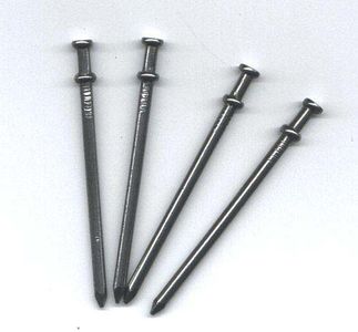

If the doors on your house has 6 screw hole hinge plates: [See Picture (2A)]
Remove 2 screws 1 from the door frame (doorjamb) side of the door and 1 from the door itself [Do only one hinge plate at a time], the ones that are directly across from each other on 6 hole hinge plates. With the door wide open and looking at the hinge plate see picture (2A) the hinge pin on either side there will be 3 screws on one side and 3 on the other they're mirrors of each other if you were to connect the screw heads like connect the dots they would look like this < > the screws that makes the points on the hinge plate [this screw →< & >← this screw] are the ones you are to remove. The screw hole in the door frame (doorjamb) hinge plate is where you will drive the duplex nail [see picture (1A)] the nail needs to be driven in straight and level so the nail's secondary head that is partway down the nail shank sits flush within the hinge plates screw hole [see picture (2A)] then use a hacksaw to cut the main nail head off, this is the one you used the hammer on to drive the nail into the door frame (doorjamb) with. Once the nail head is cut off you will need to make sure that the remaining shank is straight I know this is the second time I've said this but it is important because the remaining shank of the nail is going to go into the open screw hole on the door if it is straight it will go in without any problems do this for each hinge plate on your door. Some doors only have 2 hinge plates, where as some have 3 for better strength & security.

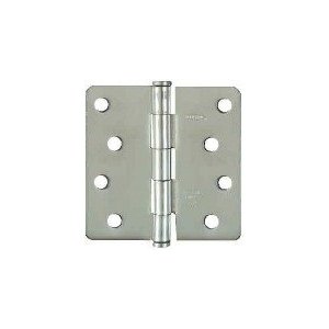

If the doors on your house has 8 screw hole hinge plates: [See Picture (3A)]
Remove 4 screws 2 from the door frame (doorjamb) side of the door and 2 from the door itself [Do only one hinge plate at a time], the ones that are directly across from each other usually on 8 hole hinge plates. With the door wide open and looking at the hinge plate [see picture (3A)] the hinge pin on either side there will be 4 screws on one side and 4 on the other they're mirrors of each other remove 2 of the screws of your choice of the 4.* The screw holes in the door frame (doorjamb) hinge plate is where you will drive the duplex nail [see picture (1A) & (3A)] the nail needs to be driven in straight and level so the nail's secondary head that is partway down the nail shank must be flush with the hinge plate See Picture (2A) in the screw hole then use a hacksaw to cut the main nail head off, this is the one you used the hammer on to drive the nail into the door frame (doorjamb) with. Once the nail head is cut off you will need to make sure that the remaining shank is straight I know this is the second time I've said this but it is important because the remaining shank of the nail is going to go into the open screw hole on the door if it is straight it will go in without any problems do this for each hinge plate on your door. Some doors only have 2 hinge plates, where as some have 3 for better strength & security.

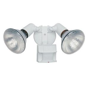

do this for ALL the outside doors. (4A) Replace ALL the outside lights on house and garage with these. (5A) Then put these in areas where lights should be but there is no power source for them so that if someone tried to walk around the house at night that there would be no way get near the house or garage without them getting lit up so ANYBODY and EVERYBODY can see them, crooks HATE drawing attention to themselves. (6A) Get a bunch of security window stickers and put one on EACH window if there are 2 parts make sure there are a sticker for each and then get 2 security signs one for the front yard and one for the back too. (7A) Then you can go one step farther if you want you can install phony CCTV cameras (they even have ones that has a blinking light and evens turns side to side in a sweeping motion). (8A) Then find the biggest pile of fake dog poop you can find (because big poop = BIG MEAN DOG).
*This is where you can be a little creative with where you put your duplex nails on the hinge plate, I personally would do the top and bottom hinge plates the same. If you do have a middle hinge plate then you can use the other 2 holes but DO NOT put the nails next next to each other skip to the next hole having the duplex nails side by side because this will reduce the effectiveness words in other words holes 1 & 3 or 2 & 4 BUT NOT 1 & 2 or 3 & 4.
