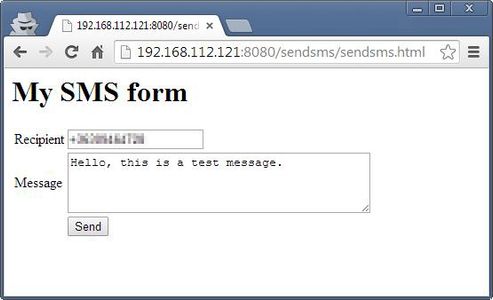

Having done all the previously presented configurations, let’s test the SMS application. You only need to open the following URL in a webbrowser:
http://192.168.112.121:8080/sendsms/sendsms.html
(The ’192.168.112.121:8080’ should be replaced to the corresponding data related to your Raspberry Pi. The ’sendsms.html’ refers to the HTML file that contains the code of the SMS form.)
Enter a text message into the ’Message’ text input field, then click on the ’Send’ button.
Therafter, a PHP file will be loaded that contains the URL that has been sent to the SMS gateway as a HTTP request, and it also contains the HTTP response, which verifies that the SMS gateway has received the message. This response also shows that the SMS web application works well, and can be used to send SMS messages effectively.
