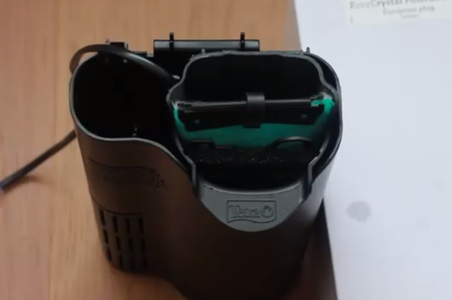

4. Tetra crystalclear filterbox 300 (completely silent, but probably not shrimp safe - I will add a pantyhose at the suction inlets)

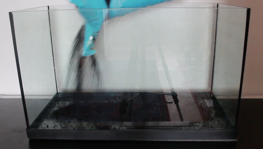

Step 3: Add Shrimp Soil
- I ve used a special shrimp soil which doesn't need to be cleaned in advance. Additionally, it helps to keep the water clean, decreases the hardness of the water and lowers the PH

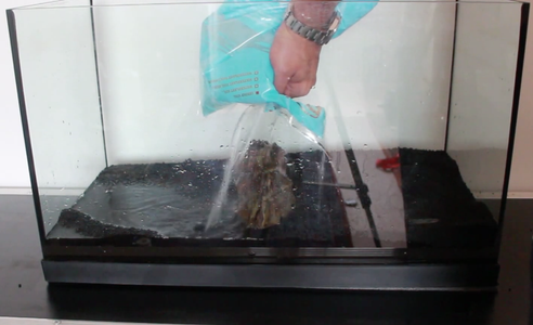

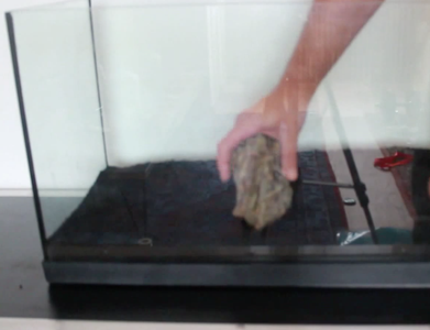

Step 4: Add Decoration
- Try to avoid plastic, use stones and wood suited for shrimp tanks (I went for an Okho rock, which looks amazing!)
- Press decoration firmly into the soil.

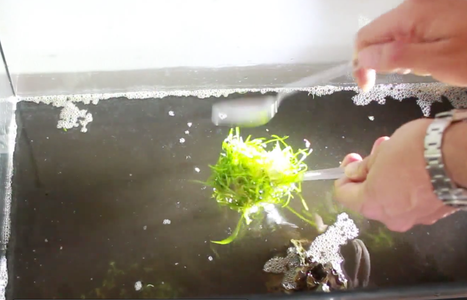

Step 6: Add Plants
- Use in vitro plants to be sure to avoid herbicides and parasites.
- Remove the agar gel so plants form roots in the soil.
- Don't touch the plants nor the water. You can use spoons, but again, take care that they are clean and free of soap.
- Bury the plants in the soil. Don't overdo it. Don't cover the whole plant with soil.

Step 8: Install the Filter
- Use a filter which suits the size of your tank and is shrimp safe.
- If your filter is not shrimp safe, pull a pantyhose over the suction inlets.
- Install the filter at the side/corner of the tank to create a current and to hide.
- Turn the filter on. It has to run 24/7.

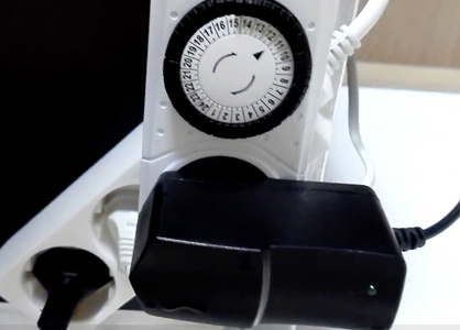

Step 9: Set Up the Light
- I ve installed a DIY LED light (1x 3W white and 1x 3W blue LED on a single heatsink for 10W LEDs) with a DIY driver (LM350 regulator, resistor - see my other instructable on a DIY flashlight)
- You can also buy a light. Take care that it suits the purpose and size of your shrimp tank.
- Use a timer switch. Start with 5 hours of light a day. Increase half an hour per week until you reach 10 hours per day. This helps to prevent an algae plague.
