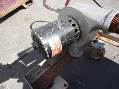

Step 5: Introduction of Air
With the air vent lid closed plug in the motor. You will hear the motor running but it will not affect the fire until you open the air vent lid. When opening the vent lid do it gently, and just a little bit at a time until you hear a big Hwooosh sound resembling a jet engine. This is the sound you're looking for: it means the fire is circulating inside your furnace ensuring even heating of the crucible.
