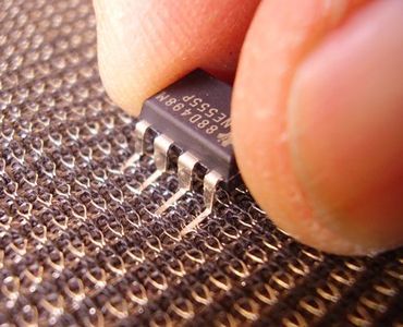

Step 4: Preparing IC's
If you want to sew IC's first you'll need to check that their legs have a 2.54 mm (0.1") pitch. As an example we will use a 555 timer that has 8 terminals. Proceed by carefully bending 90° with your pliers all terminals on one side at the same time.
Step 5: Placing IC's on Perfboard
Holding the IC with your fingers carefully insert one side in the fabric, taking care that terminal tips remain inside the fabric. Terminal tips must be parallel to metal stripes. Gently pull the fabric and insert the other side, so that, when you release the fabric, the IC is firmly blocked.
Step 6: Sewing IC's
Now you can proceed by sewing all terminals with the same procedure seen for the resistor. Once finished you should cut out the fabric in between the IC terminals because if not they will be shorted. If you have any kind of 'Spray Seam' or hairspray apply to the area, so that fabric doesn't fray. Proceed as shown here. With sharp point scissors cut a square/rectangular opening being carefull to completely remove all metal stripes and wires that connect terminals. I suggest to check with a tester that there are not unwanted connections between stripes and across terminals.
