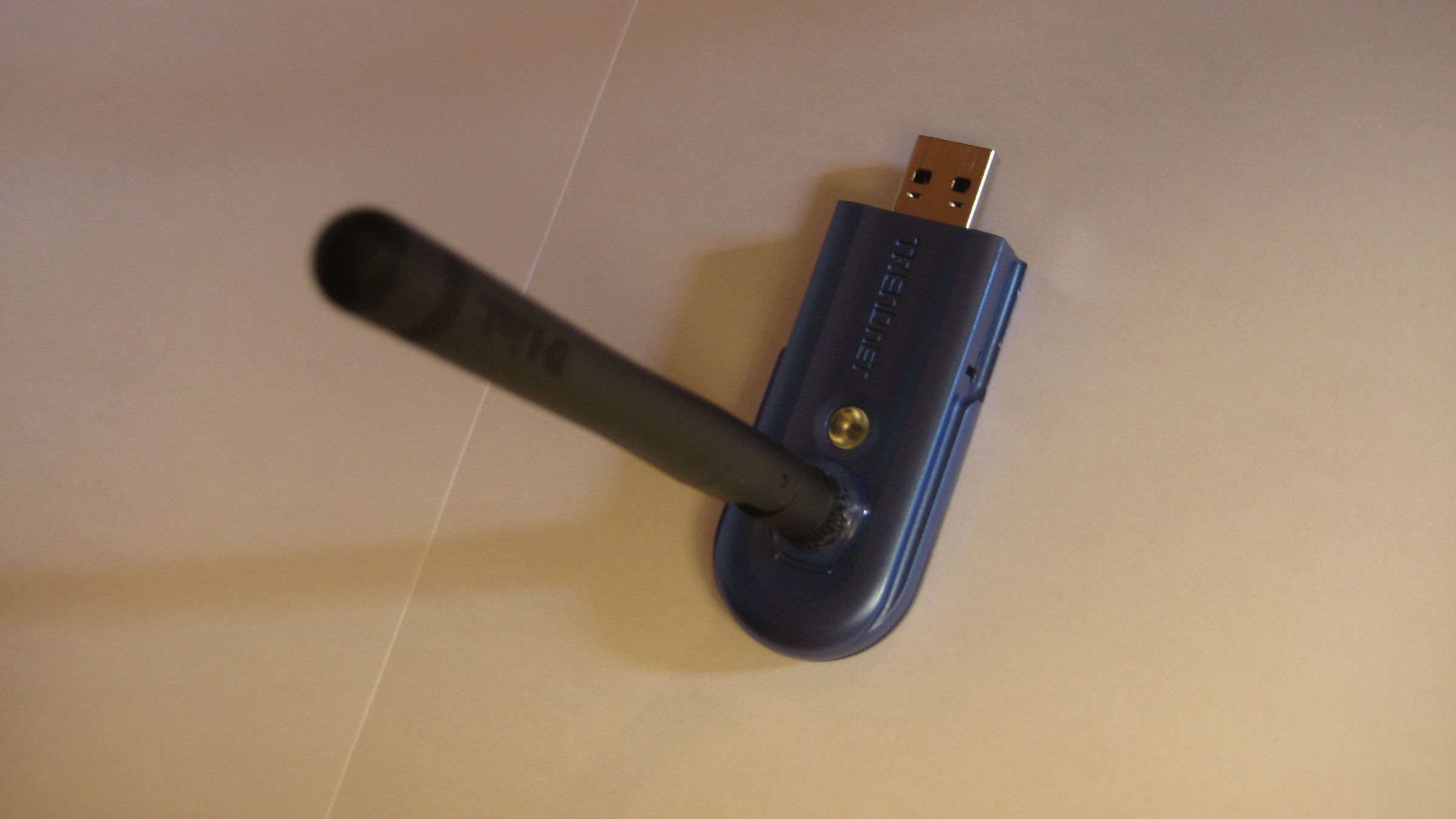

A wireless network adapter. (Preferably USB, but any will do)

First of all. Use a Ethernet cable to connect the 1st computer, with the second one. Then plug in your USB WIFI adapter to the computer closest to the wireless access point you are trying to reach, (or if you have already done that skip this step).
