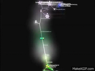

Step 1: Video History From Ardulink Project
This is video I've produced from the Ardulink repository (http://code.google.com/p/ardulink/).
