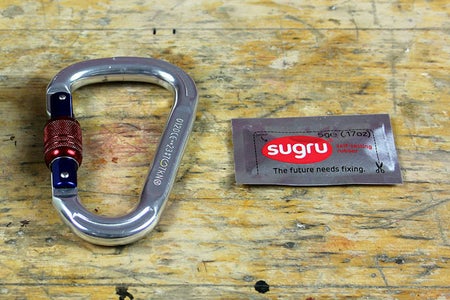

All you need for this project is:
- A carabiner
- A minipack of sugru.

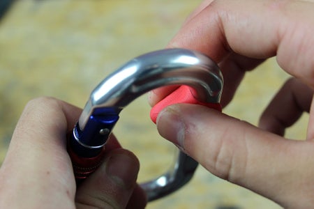

Open up your minipack of sugru and kneed it in your hands for about 15 seconds, until you have a nice smooth ball.

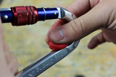

Squash this onto the carabiner.

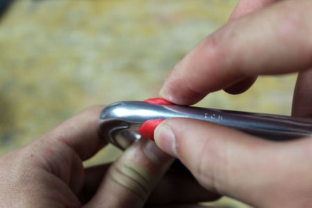

Start by wrapping the edges around the carabiner, eliminating any gap between the metal and the sugru by working the edges down with the tip of your finger. This'll minimise the points that the sugru could tear at, ensuring your hack keeps on going.
TOP TIP:
You can use the edge of your finger as a roller to ease the sugru down onto the carabiner. This also provides the right kind of curve for the hooks base.

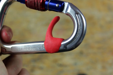

Once you've got a solid base of sugru on your carabiner you can start to create the actual hook.
Start to ease the sugru into the shape of a hook. Do this by gently pinching and smoothing the sugru through your fingers, whilst moving them out from the wall of the carabiner. This'll slowly pull the sugru into the correct shape. Keep doing this until a hook is formed.
You want the hook to be thin enough to be flexible when cured to allow the belay loop in and out, but thick enough to withstand continuous use. Similarly, it should be long enough to keep the belay loop at bay, whilst allowing enough of a gap to easily remove the hoop when needed.
