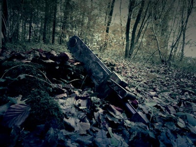

THE CHAINSAW BLADE :
The main notion was to combine a blade and the efficiency of a chainsaw. I use a material called « expanded PVC » (also known as Sintra) in different combinations of thickness, from 2 to 5 millimeters, which I stick with cyanoacrylate glue, brand of Loctite n°401.
As I always do, I first design it on Illustrator. It allows me to print the pattern on A4 sized pages to 1:1 scale.
I carve the different pieces and glue them together. For the stiffening of the blade, I insert 4 mm diameter steel spindles, held in place by hot glue.
I carve my chainsaw's pikes with my jigsaw. A quick use of sandpaper makes it sharp enought to cut out bloody zombies. Add some details as I do : 5 mm PVC screws mak it look awesome. Tip : drill the PVC with a 4 mm broach and screw on to simply create the thread.
The handle is a PVC tube glued by Loctite.

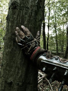

Step 3: The Gloves
To craft gloves, once again I use expanded PVC (width 5mm), for the really first layer. Some details are added with thiner PVC (3mm). To reach a more offensive capacity, 4 spikes are added to crush heads without effort. It can be sharpened at anytime. The entire glove will be maintained by leather stripes.

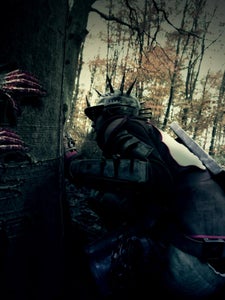

Step 4: The Helmet
Then, we will retrain a baseball helmet.
The eyeshade has been sharpened, allowing headbutts to explode your ennemy's skull. Wood or metal spikes are added to give your helmet a badass style. The deterrent aspect should not be underestimated, Mankind is true threat in that kind of situation. I have worn this armor several times, and I can assure you bullies will think about it twice before attacking you.

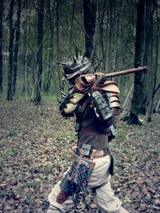

Step 5: The Armlets
Armlets has been realised using 5 mm PVC, and also maintained by leather stripes coming from military surplus. Authenticity and solidity guaranted ! Once more, I add some spikes for both style and threat in close combat.
