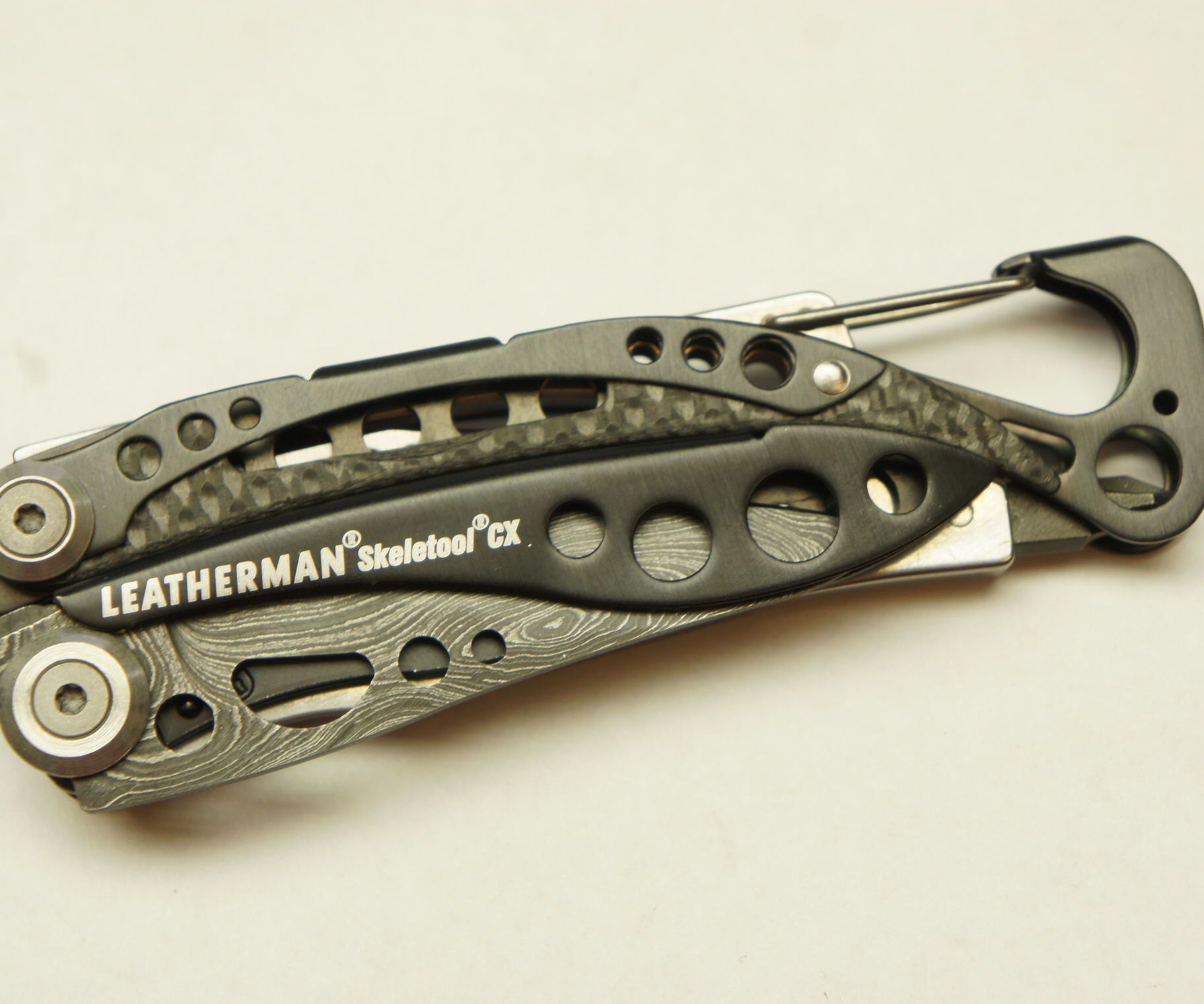

Introduction: How to Swap the Blade on Your Leatherman Skeletool, Skeletool CX, or Skeletool SX Multi-tool
This Instructable will give you the step by step on how to change the blade on your Skeletool multi-tool. The steps are the same for any version of the Skeletool (standard, CX, or SX) and any year.

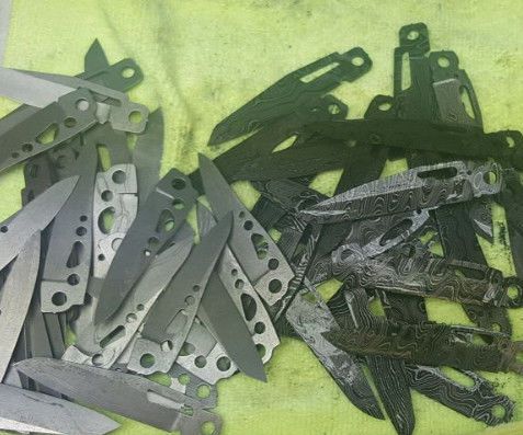

You can find replacement blades at our website:
Here are some shortcuts to the available blades for the Skeletool:
Damascus Blade for Skeletool (all versions)
420hc Combo Edge Blade for Skeletool (all versions)
154cm Plain Edge Blade for Skeletool (all versions)

Step 3: Assembly As It Pertains to the Blade
Hold your tool so that the flat side of the blade is facing up. Here's the rundown on the parts, from top to bottom:
- screw
- large beveled washer
- nylon washer
- blade
- brass bushing
- pin
- small beveled washer
- screw
The goal for the blade swap is to remove the first four items on the list without affecting the rest.
