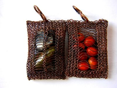

The photos featured here were originally accompanying a two hour community workshop where I was able to physically assist people. The objective was to teach people the "concept" of how knitting works, and working with the concept rather than the tools (knitting needles, crochet needles). I used 16 gauge aluminum wire for the demonstration - aluminum is much kinder to your fingers, and also, 16 gauge is thick enough to get larger shapes in less time, and you can easily see the intricacy of the method.

Keep carrying on until you've gotten to the length you want. When you are done, place a dowel that fits snugly inside your newly made tube and roll it on the table a few times. this will even out the "stitches" or loops, and will also make your tube incredibly flexible. If you have any questions, leave a comment!
Things to note:
Let the metal do the work. The wire should loop comfortably. Practice looping until YOU get the idea of how the metal wants to loop. If you try and force it to do your bidding, the metal might kink (out of sheer spite).
Don't use the awl/dowel to hook the wire through. PUSH the loop through. You're using metal wire, not thread. Trying to hook it will result in kinks (and an upset metal). The awl is there mainly for sizing the loops.
