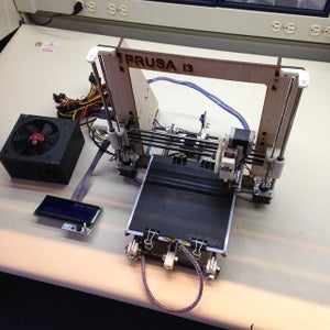

The Makelangelo 3 is an easy way to start learning how to make a 3D printer. It basically makes one layer of a 3D print, without the expensive plastic filament or the burning hot nozzle that can hurt someone. It would be great in a classroom, a library, or at home for the self-starting young genius.
I've planned the M3 so that when you've built one you know how to make a machine that moves. When you take this step and build a 3D printer the complexity goes way up BUT the only really new part is heating plastic.

The Arduino MEGA, the RAMPS board, and the stepsticks can be replaced with the Makelangelo RUMBA board and the LCD.
The belts, pulleys, screws, nuts, and the two Z stepper motors can come from the Makelangelo 3.

I've included a photo of the power supply I used in all my printers. To make them work you have to "bridge" two pins with a wire, as shown in the second picture.

To program your robot you need to use Arduino to upload printer control code like Marlin.
Walk before you can run
Marlin has some default speed settings for each motors - moving and extruding. These settings include velocity, acceleration, and jerk. In my experience with a new machine these default settings for extruding and z movement are WAY TOO HIGH. You will avoid a lot of mysterious calibration problems if you halve the speed and acceleration at the start. You can always raise them higher later.
You've seen the rest before
If you've built a Makelangelo before, you've seen the rest. XYZ Calibration challenges are the same. GCode is the same, with a few new codes. Movement is the same, but more complicated. Uploading code to the robot is the same. You've learned your letters and words, now we can start to share Big Ideas.
The newness is melting plastic
You can push plastic into the hot end too fast and it will jam. You can push too slow and it will drip out the hot end, which is bad. You can overheat or underheat and jam. It is better to drip than to jam. It is better to start with a plastic like ABS which you can't overheat. After that feel free to experiment with PLA or any of the other exciting new flavors on the market.
