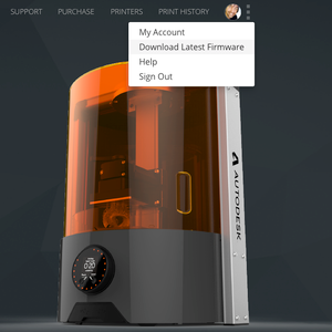

Step 1: Download the Firmware Update
Log into emberprinter.com and click on your user icon, on the top right of the screen. In the pulldown menu, click Download Latest Firmware. It will download to your default download location.
Step 2: Upload to Your Printer
Now click on Printers, find the paired printer to receive the firmware update, and click the "Update Firmware" link. The firmware update will then be sent to your printer. You'll receive a confirmation on emberprinter.com when the update is complete.
