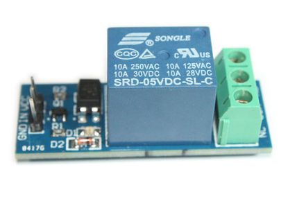

1 x Relay 220 V 10 A cost 3 Euros, sold on Ebay

Step 1: What Is a Relay?
A relay, from the external point of view is a simple switch capable of passing current or not. This phenomenon occurs through a physical principle, based on the coupling magnet that is generated through a passage a small excitation current, which is supplied by the Arduino. There are two configurations with regard to the relay:
1. NO (Normally open)
2. NC (Normally closed)
These two configurations differ only in the code you need to write in Arduino. The first configuration, in the case of switching off the relay, no current is passed (the circuit is open) and that the lamp is turned on you need to get out of an Arduino signal "HIGH". The NC configuration is dual, in case the relay is not energized, the current flows in the device and that the lamp is off, you need to do to get out of an Arduino signal "LOW".
To recap from the point of view of the code:
NO configuration
digitalWrite(relay,LOW); // Lamp off
delay(1000);
digitalWrite(relay, HIGH); // Lamp on
Configurazione NC
digitalWrite(relay,LOW); // Lamp on
delay(1000);
digitalWrite(relay, HIGH); // Lamp off
For those who wish to learn more about how this circuit element, you can visit the website of Wikipedia, which talks about the various types of relays.

Step 2: How to Connect the Various Cables Between Devices
The links that need to be done to make the project are quite simple. We have two devices to be connected to the Arduino: 1) the relay and 2) the Ethernet card.
Concerning the first, it will be necessary power the relay with 5 V, the ground and the pin-out, to be connected to Arduino pin set in the code, which in this case is 5.
The microcontroller Ethernet is slightly a bit 'more complicated, because they are well connected by flexible cables 6. There are two usual power cables, VCC (3.3 V, though!) And GND and 4, which are used to send and receive data over the Internet. Here is a table that summarizes the connections:
