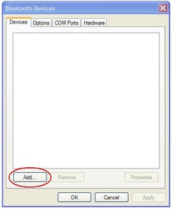

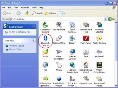

Find the Bluetooth icon. You'll should one near the clock in Windows, or in the Control Panel. (2nd image)
Open it, and click on Add, under the Devices Tab.
This indicates that it does have power, but isn't communicating with anything.

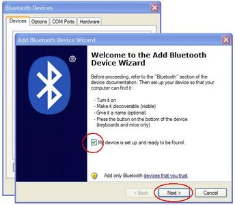

Put a check-mark in the box labeled "My device is setup and ready to be found." , then click Next.

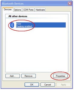

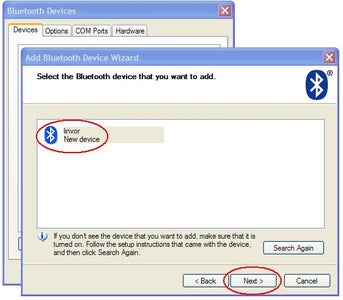

The module should be discovered with the name "linvor" (New Device). Click to select it, and click Next.
Step 5: Connecting to the Module Step 4

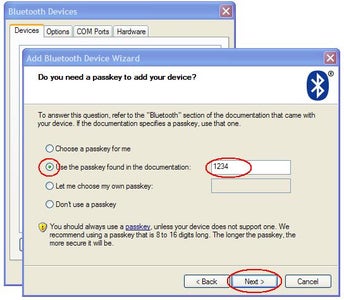

Next, we'll need to add the passkey (password) allowing us to connect to the module..
The passkey is 1234
Select "Use the passkey found in the documentation" and enter 1234.
Click Next.
The passkey is 1234
Click Next.

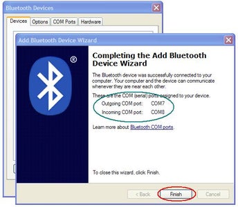

This Bluetooth device installs itself on your PC a two different COM ports. We are most interested in the lowest number.
(In my example, COM7)
Click Finish.
Click Finish.

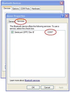

Click once on "linvor" in the Devices Tab & click Properties.(1st image)
Click on the Services tab. The COM port indicated is the one we'll use. (2nd image)

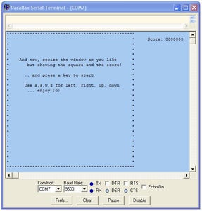

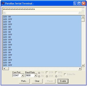

- Open Parallax Serial Terminal.
- Set the COM Port to match the one you noted in step 7.
- Set the baud rate to 9600 and click Connect. (2nd image)
You should see Snake waiting for you to press a key. Enjoy a little Snake using your PC keys a,s,w, & z for control.
Snake was written by MagIO2 of the Parallax Forums.
Step 9: Controlling the Propeller
Ok, so Snake was interesting to play with for a few minutes. It proves communication between the Propeller and PC is working.
This time, grab an LED and insert it into pins 18 and 19 of the Propeller. (1st image)
(We could have easily put the Cathode of the LED to GND, and Anode to P15, but I'm picky about bending the leads.)
Download, extract, and upload "BT_Led" to your Propeller using F10.
Open Parallax Serial Terminal once again, connect to the same COM port and baud rate as before.
This time you should be able to press a, & b on the PC keyboard to toggle the LED on and off.

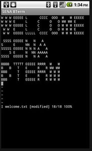

Next visit Android Market and install SENA BTerm Bluetooth Terminal. (A free application)
- Press the left-most (menu) button on the bottom of your Android
- Click on Bluetooth Management
- Click on connect to
- Click the select button
- Click the Start Scan button
- Click on linvor
- Click on Connect
- Enter the passkey (password) as before: 1234
If you have the simple LED_Demo loaded, you should be able to press the a, & b keys to toggle the LED.
If you have the Servo_Demo loaded, you should be able to press 1,2, & 3 to control the servo.
