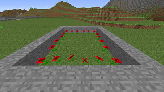

Pic One First, place any solid block in a one block high 6x6 wall. The poppies are to help count the amount of blocks.

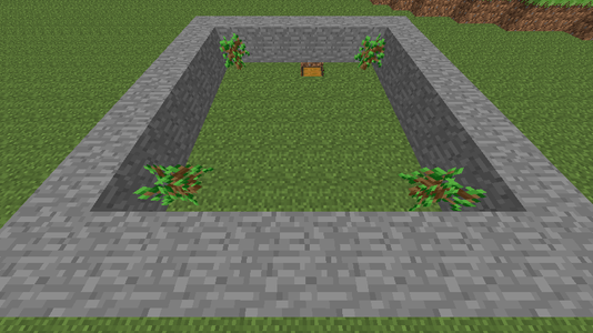

Pic Two Next, place saplings in each corner, and add a chest on the outermost row of any side of the square.
